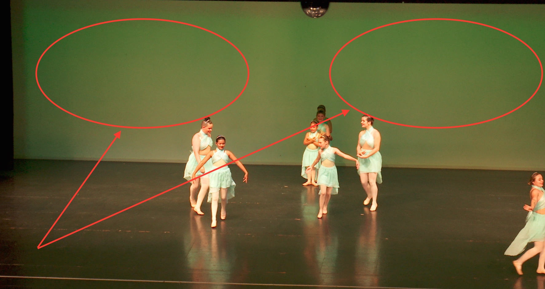

My PXW X160 seems to have an issue.
Just started the concert season and Im noticing it seems to have a lot more noise than on previous jobs.
Then Ive found it doing this rubbish with certain lights, see pic.
Are the sensors on the way out?

are you using gain? have you tried the -3db setting (given that there's probably not enough light anyway)?
i'm not aware of sensors failing by degree.
noise reduction in post?

12db on the 160 is normally very clean. Ill try 6db next show.
I did Neat video the track because it seemed dirtier than usual. I suspected that too. But that pic is from the MXF file straight from camera :(
It gets stranger though....
I went back into the project and had a more careful look. That weird green light is the only one that makes it happen.
Darker scenes with pinks and blues and even dark greens show no noise at all.
And, the dirty block noise at that time appears in the GH5 wide shot and a G7 down in front as well.
Just finished editing another concert shot the next day in another theatre with the same cameras and it has no strange things happening at all.

12db gain is the upper limit for stage work. 1/3” sensor is small. the screen cap looks like I would expect. I don’t find the noise objectionable and I doubt the consumer would either.

have to agree with pete's comment above.
and really, if your client notices what you're seeing (which i doubt), simply explain that for the price they're paying they're getting a great deal - otherwise you could simply go out and buy a camera costing three times as much as your present one and charge them accordingly ;-)
tbh, i gave up 'pixel peeping' my videos years and years ago - glitches yes, pixelation yes, but 'smudgy' backgrounds... well if they're looking at them then they're missing the action ;-)
