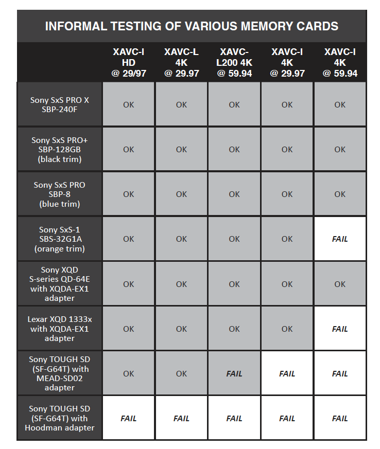

Re: Z280 and SXS-1 and SXS Pro Media advice.
Here is a chart from my Z750 book that shows the results of actual testing I did with various cards. The Z280 results would be exactly the same, except the Z280 does not have the excellent XAVC-L200 codec. The Z750 is the only camera in the world to have that codec right now.
I hope this answers your questions. Oops, I just noticed one of the FAIL boxes isn't white. Gotta make a note to fix that in the next edition.
