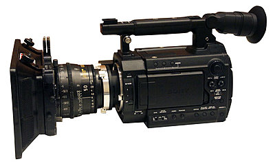

I think what they are trying to do is lure in some of the people who are used to this kind of design. Though it just makes us pros shy away from it. Stupid move. Justifying a 16k price for something that looks like its worth 4k or less is not a good way to get costomers.
There is such a thing as sex appeal for cameras and its always the same, they look like the F35, or the Alexa.
You are right it wouldn't have cost them a red cent to design this thing in a better form factor. The PL mout with a zoom handycam rocker is just ridiculous in design and completely useless for people who will actually USE the PL mount. You could have even saved money not having to put the VF on there and put that towards a second HDMI port just for viewfinders and such.
Oh well, sometimes I really think these companies have the weirdest people designing for them, they are clearly NOT cinematographers who'd use this stuff. Its like they make it look ugly on purpose.
And that ugly little mic hanging off the front as well... eek. And why the heck did they put the XLR's right next to the lens mount? thats going to get in the way of any mounting gear with all the XLR cables getting in the way and sticking out.
A real miss for design, but the footage is so amazing I'm stuck with having to buy it haha.
This is the best photo I've seen of it yet though, with none of that crap hanging off of it, thats as close as you can get it look to something professional.
