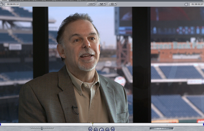

Today is the first time I used my F3 on a paid project. I had really done very little testing beyond basic record and playback and even though it was a fairly simple talking head, I actually brought along my EX1 in case I ran into any snags.
I was shooting in a baseball stadium and my client requested that I include some of the exterior in the background. I had neither an HMI or enough tungsten power to match the outdoor exposure. I had brought along a roll of .9 ND, but it was not enough to cover all the windows with two layers, so I let the brighter windows work as an edge light. The front light was an Omni 600 in a Chimera box with a half blue and a small white card for fill. I used a 1/2 blue rather than a full to get a little more stop out of the light.
My lens was a Nikon 24-70 2.8 at around f4.0 and it worked great with the MTF, although making exposures repeatable was difficult using a G style lens. This image is was shot without any profile setting. I shot using a Nanoflash as well as to the SXS. This result is from the Nano.
At one point during the interview, the sun began reflecting off something in the stadium, boosting the edge light above 100 ire, based on the waveform in my PVM-740, but in the blow up, the image held pretty nicely. Detail is incredible.
I've only included a screen grab as the video is not ready for release
I'll be using this camera in all types of situations and a lot of it won't be dreamy imagery. I've got to make it pay for itself.
All in all I was very impressed (and relieved) with the camera's first performance.

That pic looks very good.

The first thing I did was try to find the moire on the jacket, but I didn't see any.

There was no moire, Great sharpness and detail without added noise.
This was shot at +6db..
