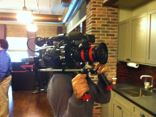

Originally Posted by Andy Shipsides View Post
I'm not a big fan of any rig that puts the camera out in front of you.. Just too heavy and especially with a zoom lens.
I put together this for a test shoot (sorry for the low quality pics)
Yfrog Photo : yfrog.com/h2cu4bj - Shared by AndyShipsides
Yfrog Photo : yfrog.com/h4ftkbhj - Shared by AndyShipsides
Yfrog Photo : yfrog.com/h2250ynj - Shared by AndyShipsides
Hey Andy,
To me, that rig and the handles do not look comfortable because the right arm is so close to the body. I have the entire Zacuto newsman rig with doublemount and red plate at the rear and my rig with an EX3 is soooo comfortable with little to no stress on my back (I have a bad back). All the weight is placed on my biceps and a little on my shoulder. Any chance you can assemble a similar rig with the F3 and snap a photo for us?
F3 rig for ENG/EFP style work-abel_andy.jpg
Combines a base plate, grips, EVF, follow focus, and a battery plate in the back. It felt good on the shoulder even with the small Optimo zoom. By putting the viewfinder to the side and putting thecamera on your shoulder, the whole rig become more useable.

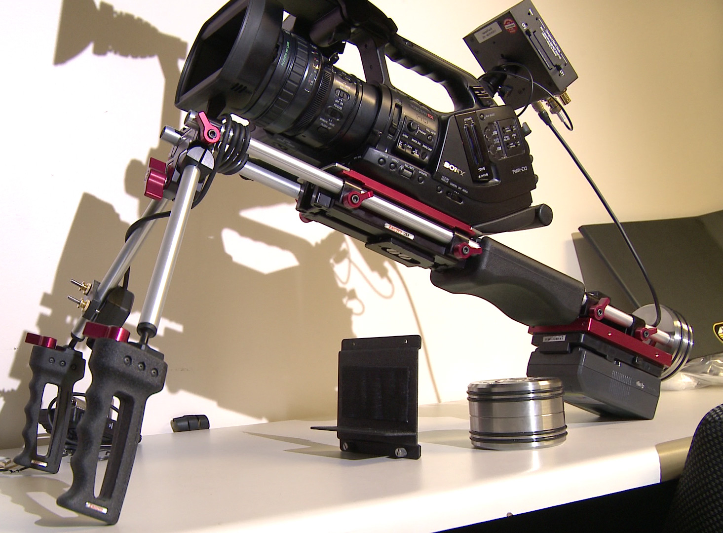

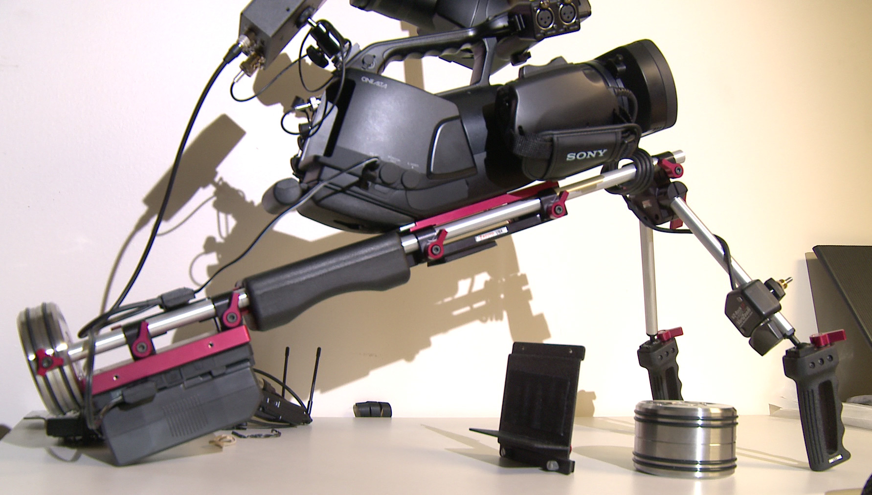

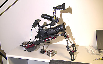

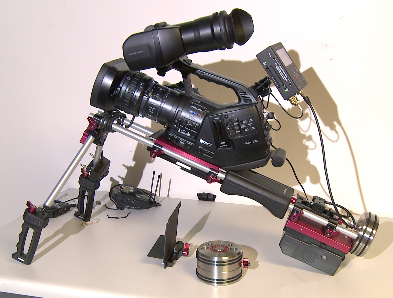

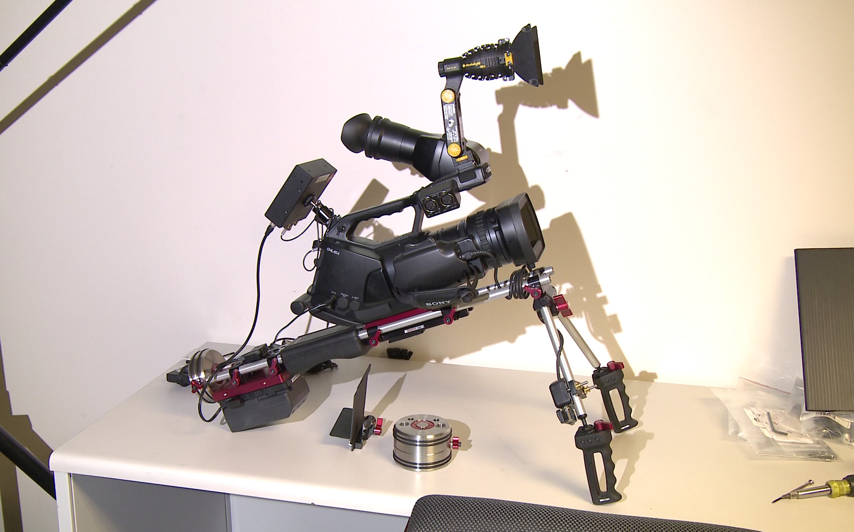

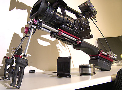

Here are some images of my rig. I only had my EX1 to shoot video and take screen grabs for these images.
The list of parts:
1) Zacuto Newsman Baseplate Kit
2) DoubleMount w/ 7" Rods
3) Red Plate
4) Wireless Plate
5) Switronix GP-S V-mount plate
6) Wireless Bracket (this was given to me by a friend)
7) Zacuto 24" Male D-tap to Female D-tap and Camera Power "XP-EX-Z24"
For perfect balance with a Dedo LEDzilla on front, nanoFlash and wireless receiver on a t-bar on the rear shoe, an 88whr Swit battery and the 3.5lb weight on the back.
This rig has been the savior for my back. Hand holding an EX3 or EX1 for 10 minutes starts my back pain whereas I have gone over an hour with this Zacuto rig with zero back pain. For me, this is worth every dollar. Another big plus for Zacuto gear is the lifetime warranty and great resale value in addition to being modular with thousands of possible setups.
I keep the EX3 on this rig all the time and use a Sachtler FSB 8 which handles the weight without a problem but my FSB 6 cannot handle the weight. For most of the time, I do not use the 3.5lb weight and I use a Litepanels SolaENG 3 rather than the Dedo most of the time.
F3 rig for ENG/EFP style work-zacuto1.jpg   F3 rig for ENG/EFP style work-zacuto2.jpg
F3 rig for ENG/EFP style work-zacuto3.jpg   F3 rig for ENG/EFP style work-zacuto4.jpg

Looks like a well balance rig but with the F3 viewfinder behing far in the back, you'll probably have to add an EVF to the side for this to work.
Good pics though, thanks for sharing those.
