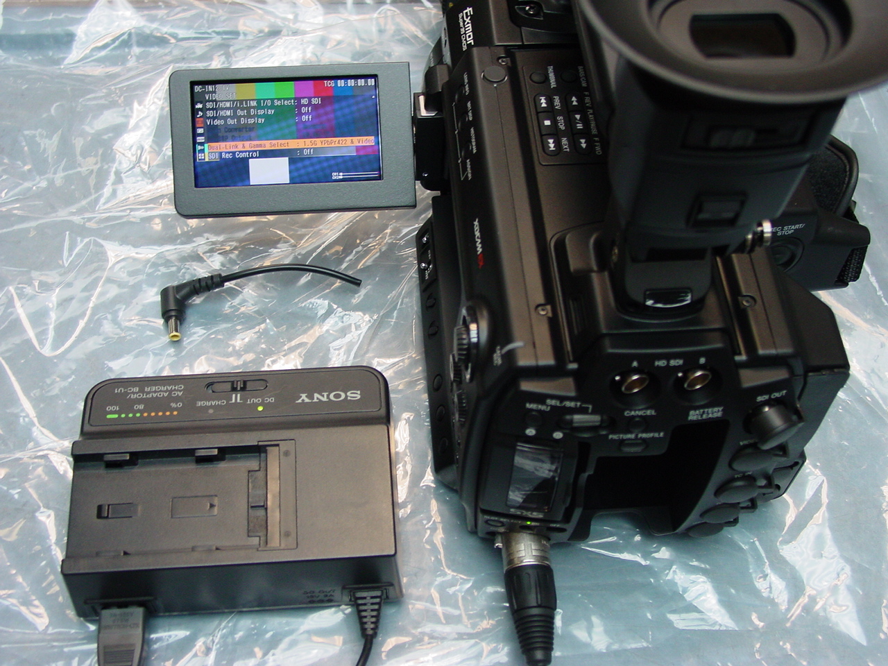

My tech did a quick test and you can power the F3 through the BCU1 and also the BCU2. He cut the cable and solder it. It works.

This is something I'd like to do as well. Could you maybe get your tech to describe which cables go to which pins? All I have to do is get a four pin XLR-plug, right?

There are 2 wires from the charger cable, Positive and Ground.
Get a four pin XLR plug, Pins #1 (ground ) and #4(Positive) and solder the positives and the grounds.
