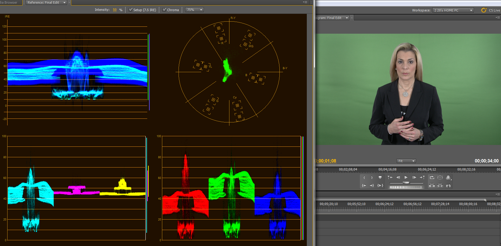

Steve , what IRE do you put your green screen at when shooting with the EX?
Old February 26th, 2011, 11:59 AM   #18
Join Date: Aug 2009
Posts: 1,554
Re: F3K for miniseries (recording options)
About a stop below or above the talent, usually below. Here is a screenshot with very quick test to show my producer/talent something I can do; so, understand that this clip isn't exactly how I usually set it up. I use 2 Kino Barfly 200's for the GS and 2 Diva 401s for the talent, but for this shot, I forgot to remove the louvers from the Diva's. And I didn't have time to setup a SolaENG 3 for backlight and I haven't received a new gel pack yet so I can use magenta.
I did fine tune the PP settings and noise has been reduced a good amount. Rather than large blocks of noise, its more like mosquito noise but I have only checked 50Mb 422 L-GOP vs 35Mb.
