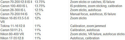

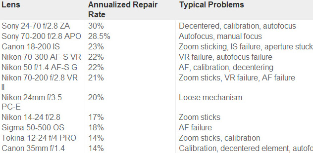

FYI, from all the tests I have seen, Tokina usually has the highest CA.
Over at lensrentals.com, they usually publish their repair data, and there are always a several very expensive 'Pro' lenses that suffer some sort of mechanical problem.
Look at the most recent data report. Here is the original link LensRentals.com - Lens Repair Data 4.0
After seeing the data on my favorite Sony Zeiss lens, 24-70 2.8 and another great Sony lens, the 70-200 2.8, I am rethinking my plan on using mostly Sony Alpha lenses with a F3. In addition, they reportedly cost wayyy more to repair than CaNikon.
Nikon/Sony SLR vs Zeiss SLR vs Cine Lenses-lens_data_crop1.jpg   Nikon/Sony SLR vs Zeiss SLR vs Cine Lenses-lens_data_crop2.jpg

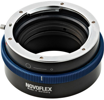

Has anyone used NOVOFLEX adapters? They make Nikon G and Sony Alpha manual aperture adapters and look to be a bit easier to use than MTF because they have a ribbed ring.
