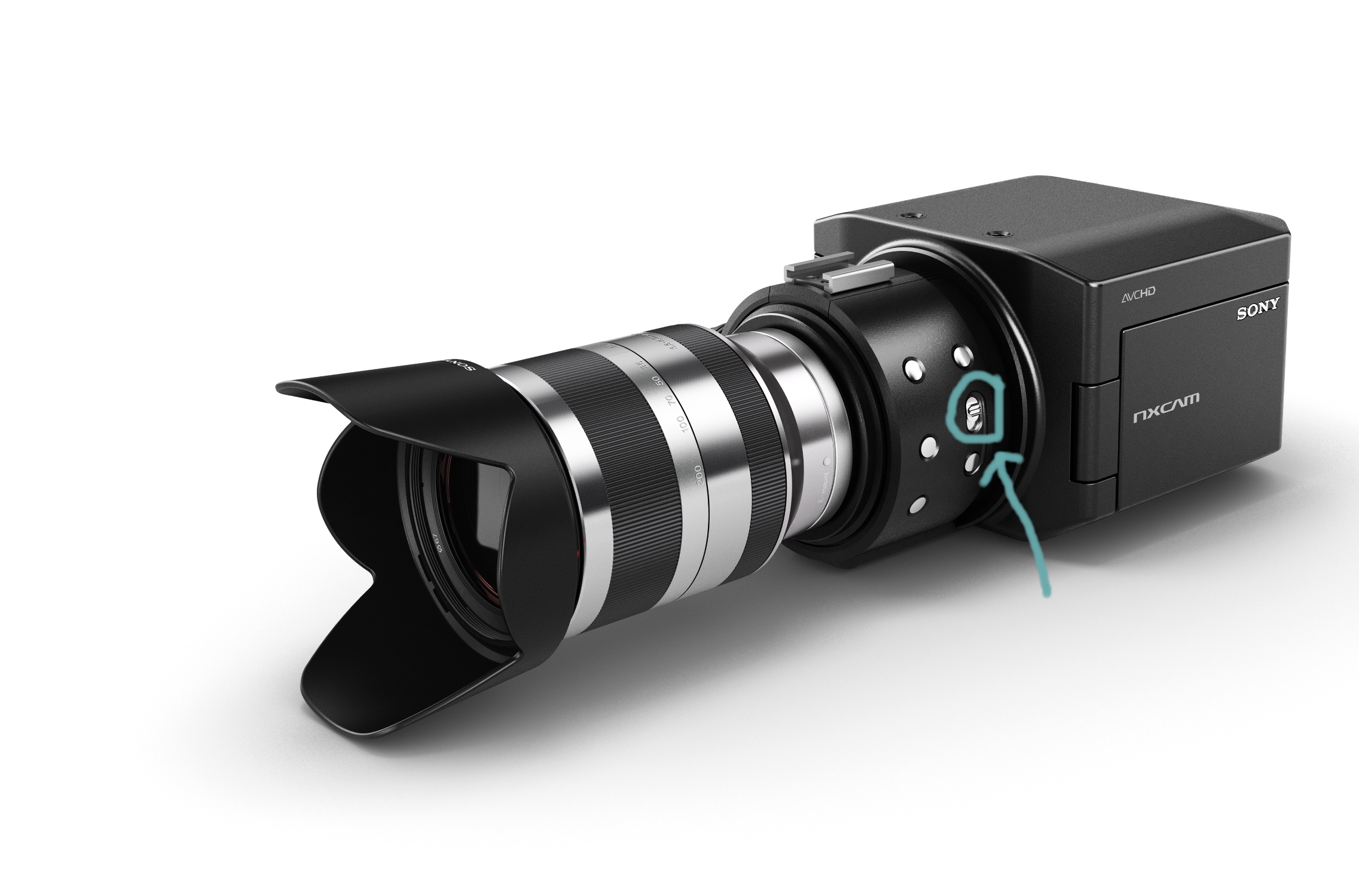

No ND filters on the NXCAM....
Hey Alister did you see the working model? From the prototype images it shows a switch very similar to ND filter switch on all sony camcorders. If what you say is true that really makes me think twice about that camera.
Edit: I attached a picture of what I'm talking about.
Monday Isa is offline   Reply With Quote

Alister, a fair number of shots of the pre-production S35 NXCAM that floated about a few months ago clearly showed an HD-SDI output on it and Sony reps even made mention of it back then. I did not see any evidence of an ND switch on the unit so this aligns but it is a very odd decision given the AF-100/101 has a few built in NDs.

Sony have made it very clear in discussions that I have had, that the NXCAM will not have HDSDi, even if it does I doubt it would be 10 bit. There is no ND switch, the barrel that the sensor is in is too small to incorporate an ND filter.

Sony have made it very clear in discussions that I have had,... There is no ND switch, the barrel that the sensor is in is too small to incorporate an ND filter.
Bummer. Thanks for the info Alister
