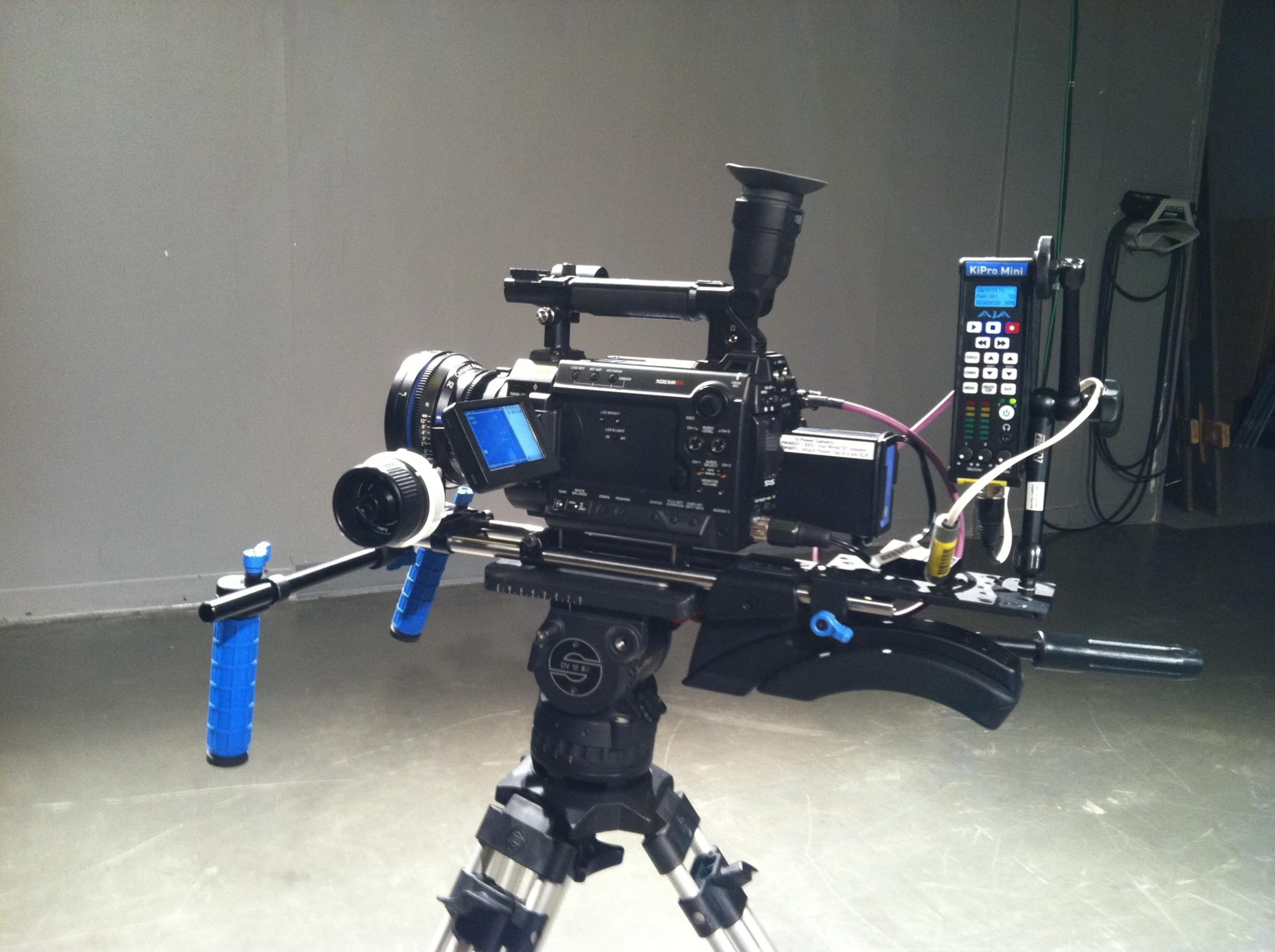

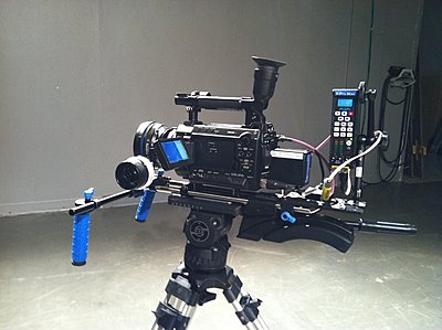

Attached a picture of the rig I built for a student who needed hand held and the Ki Pro Mini, using available parts from our Red Rock DSLR rigs.
The weight is pretty even with the CP.2 on the front, and the shoulder pad moves forward when you take it off of the tripod. The position of the Ki Pro is different than in this picture, but in reality it just showed us that having a better mount makes more sense. Really, just ignore the Ki Pro + Cheese on the back there, it's certainly not how I would have done it if I had the ability to purchase some of the solutions.

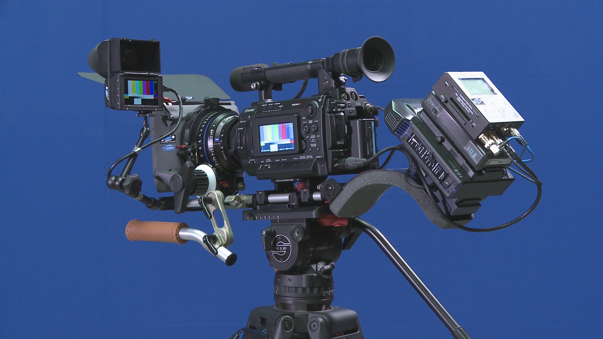

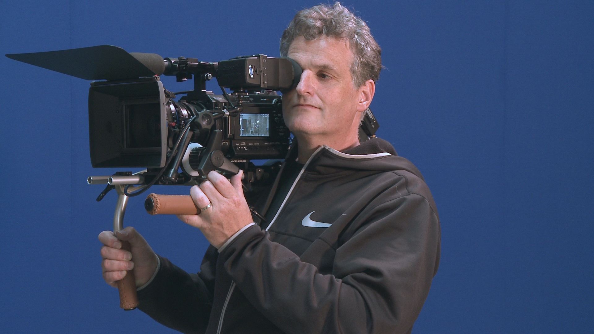

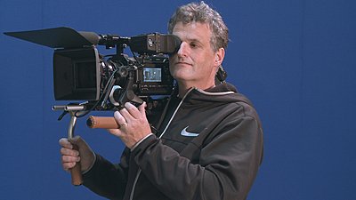

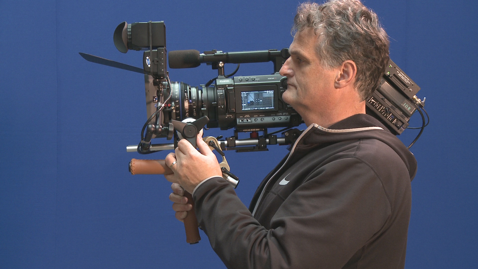

I struggled with the shoulder rig as well. with 'medium budget' and continues altering I came up with this vocas rig. Tried to keep it as light as possible and efficient on batteries. This rig runs 3 hours on the cams BU060 and a IDX Endura 7s and charging takes less time then draining.
I use a Marshall 7" monitor and the cineroid (notice the rubber band around it). Due to its weight I prefer the cineroid. Hence, most of the time I use the peaking function and as you see I use the IDX camwave wireless for the director. He gets a clear, uncompressed picture on another 7" Marshall in a comfortable handheld receiver set.
In sunlight nore the marshall or the cineroid works ok. I'm forced to use the viewfinders eyepiece but then you have the problem to keep it in places and (as this is a unique photo me not sweating) you get condens on your glass. Luckely with the peaking at the max, most of the time I come home with the right thing in focus...
I changed the shoulderpad filling from it's original rubberpad to soft foam because the rubber kills skin over bone on your shoulder and you get less sweating. The battery plate on the back with the transmitter and nanoflash as counterweight makes the cam less frontheavy. The grips are close to the body to conveniance in longer runs. grips far from the body is a killer. I have the left handle horizontal to run the starknob at the followfocus. There is just enough room to move the mattebox forward and change the lens. These Zeiss compact primes are great. With bigger lensesn it takes you more time to changes, cause you have to remove the VFarm. It has to be there otherwise it is in the way for iris and focus.

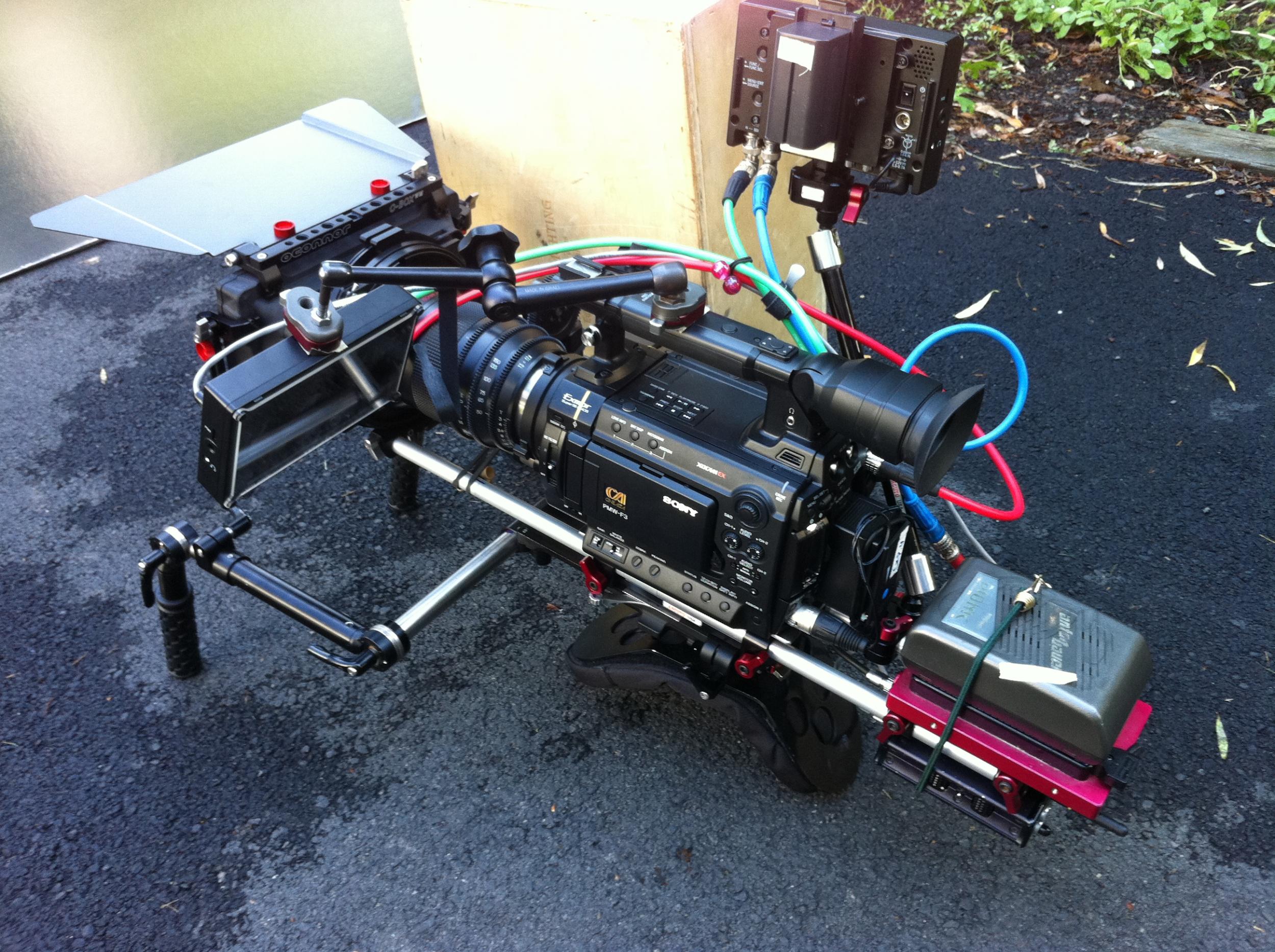

did a job with red zooms and the ET Mantis, great handheld device!
got pretty heavy towards the end of the day, 2- 5.6 tvlogic monitors, bartech wireless focus, Oconnor Obox,swit96 battery and red plate with anton bauer battery.

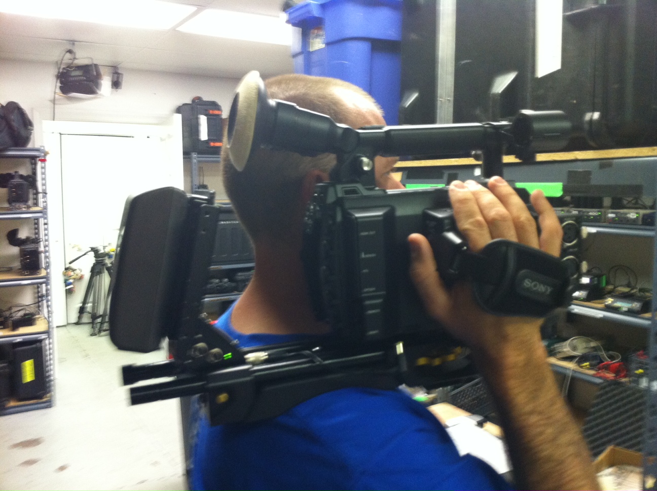

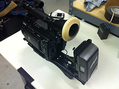

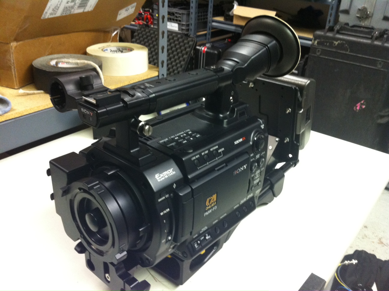

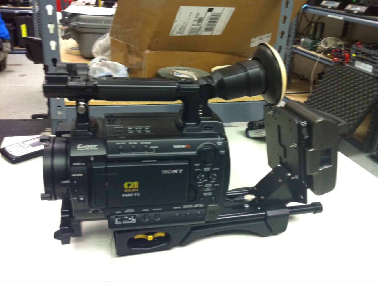

As a test, I mounted the F3 (along with a Zacuto mini-baseplate) on the EXMount which I love for my EX3.
These are just quick demos, and it does elevate the camera a bit higher than one might like, but without the baseplate, the camera seats perfectly onto the mount (which snaps directly into a VCT-14 plate on the bottom) and gives a tidy handheld rig, minus any bells and whistles like a mattebox and follow focus. In this configuration, if you needed an external recorder, monitor etc- one could use the Berkey top plate...
