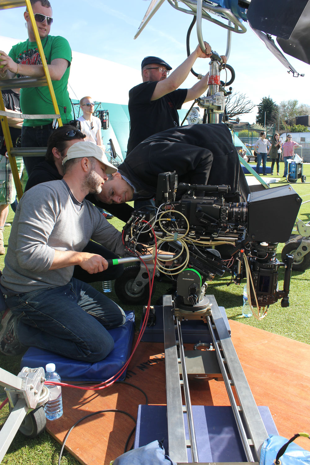

Attached is a picture of the twin F3 rig on a genus hurricane 3d rig sitting on a nice O'Connor 2725 head on a Chapman 6ft slider. The lamp behind us is an 18k that was spotted and being panned to follow the action! Lens were 50mm Zeiss Ultra Primes.
