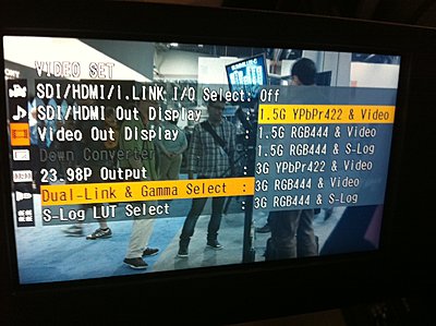

Re: HDSDI & HDMI working simultaneously
Current software as is allows you to have HDMI and SDI both active, use following menu settings:
F3 at Sony NAB booth was using the left dual link BNC port to send SDI to the monitor, while providing a HDMI signal to a Cineroid EVF.
Regards
Steve
Can you list ALL settings in this part of the menu?
I am trying to set it up and the selected choices from your image are not active.
Steven S. Miric is offline   Reply With Quote
