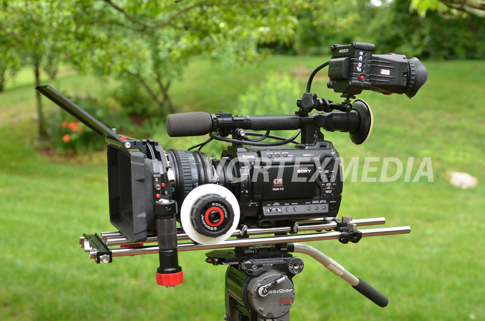

Here's another view.

Hi Doug,
Nice setup.
Have you had occasion to use the EVF in a gain requiring, low light situation? I've noticed quite a lot of grain in the EVF's image beginning with +6db, while the cam's evf and LCD remain free of same.
As for the eyeglass issue mentioned by one poster, I've noted that I cannot use my progressives but a pair with single prescription lenses works well.

Doug, I'd be interested to know why you would mount the Zacuto EVF at the rear of the F3, right above the Sony VF.
Assuming that the F3 in your photo is not destined for a roll about a studio, I would have thought that a position to the left side of the body and more forward (near to the ND's) would be more comfortable and familiar. Would that not feel more like using an Arri SR or any of the usual shoulder mounted video camera?
That's what I would have thought, too, but when I tried the VF further forward and it didn't fee right to me. It put me too close to the follow-focus unit with such a short lens. The rear position just feels more comfortable to me right now, but I don't know if that will be the final location or not.
I guess the photo doesn't show it, but the VF is NOT actually directly behind the camera, it is to the left of the body. This gives me approximately the same kind of feel operating the camera as where I would stand with my F800. This distance from my eye to my left hand would be about the same on either camera.
I think the point here is that Doug is using the EVF primarily as a tripod mount EVF, not particularly in a hand-held config (which one would presumably position differently.) Another analogy would be that the EVF is positioned about where the eyecup would be when using a film camera with the normal extension eyepiece used by most operators when ot a tripod. It all depends what you're used to...
