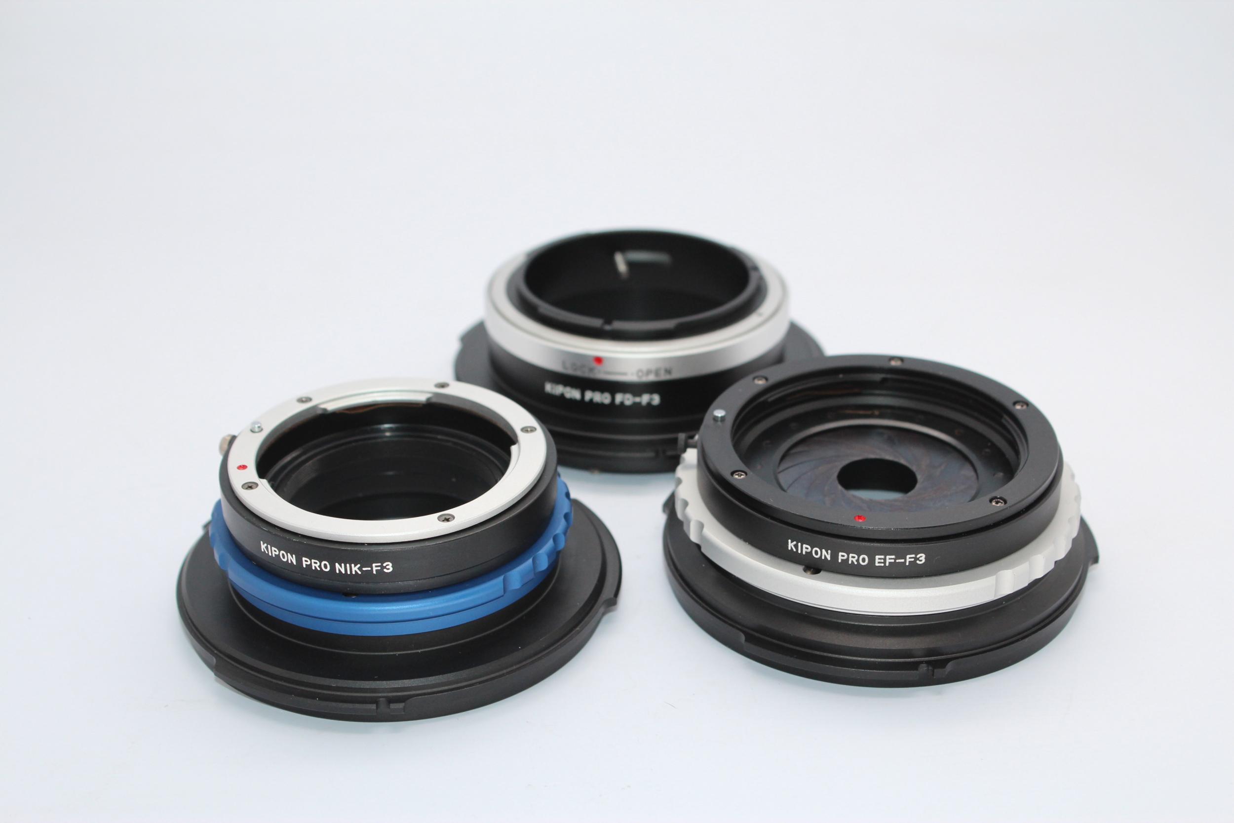

Here's the picture of the prototypei received from them.
The canon adapter is the first prototype (hence the dirt on the iris) and will be on sale at the end of the month.
The Nikon is already on sale.
PS: even if it vignettes, i prefer to have an iris to see what it looks like before taking-off the lens.

This is not a good design. it dosen't control the aperture AT ALL. It just vignette. I can't understand what they were thinking when they designed it. It can't work. I have one for the FS100, and the iris is useless with any lenses.

But if it costs half the MTF or Adaptimax and you have the option to "preview" the aperture...
why should i get the more expensive options?
Tony Partamian is offline   Reply With Quote
Old August 19th, 2011, 08:03 AM   #13
Location: Cornwall UK
Posts: 793
Re: new EF adapter coming soon
Maybe because they work

It can't even preview the aperture. The center stay overexposed while the edges vigniette. Trust me, it's completly unusable.
