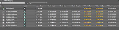

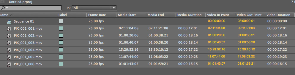

I am using firmware 1.04 on the PIX and 1.2 on the F3 while recording ProRes 422 at 1080i50. When I load the footage into FCP or PremierPro 5.5 a random number of clips will have totally the wrong timecode. It could be just a couple of clips in the middle (or nearly all of them) but whatever readings I get will be the exactly same in both FCP and PP5.5. Put the drive back into the PIX and everything reads as it should. It's as if the PIX is reading/writing timecode differently to the edit programs?
Here's a list of 6 x 20 second clips imported into PP5.5 recorded concurrently starting from 01:00:00:00 - Just the 2nd, 3rd and last ones are correct !!! - Weird.
