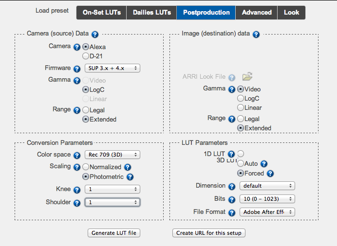

I installed LUTBuddy but how do I get the Alexa Log-C LUT installed in it?
LUTBuddy is pretty short on documentation, especially where it comes to LUT formats it accepts. The Arri LUT generator, as a last option, allows you to pick a file format.
I'd start with a LUT for Apple Color (.mga), and then work my way through the other LUT formats (with a concentration on non-high-end color correction programs)
I assume once LUTBuddy is installed as a plugin, it's straightforward to get it to recognize a LUT file? As in, a README file tells you where to put the LUTs, etc etc?
Do i need Colorista, and if so can the Free version suffice?
It HAS to be better than the FCP 3-Way.
I did go to the Arri site and downloaded what i thought were a bunch of LUT's, but LUTBuddy didn't recognise them.
Lotta options on that generator site. I've made a screen grab of the options I recommend. Take special note on that last pulldown menu in lower right. You're gonna have to try a bunch of different file formats until you happen upon one LUTBuddy likes.

That helps. Good to know that I'm on the right track with the Arri site & just need to experiment with file formats. I found some pretty good documentation on LUT Buddy and a tutorial that shows you how to build a preset LUT using colorista and Curves in AE then you can import that preset to FCP. Actually I very quickly built a LUT that was pretty reasonable.
The Natress FxFactory "Curves & Levels" plug in also looks promising so its all starting to look like I night be able to give clients an easy roadmap to slog grading so they don't freak-out. (I found a glitch that Graeme is working on though.)
Why do you prefer Colorista Free to the FCP 3 way? On quick glance they look pretty similar tho Colorista might be a little easier & faster to use.
Can you make that Arri screen grab available or send it to me @ <NSLL@pacbell.net>?
