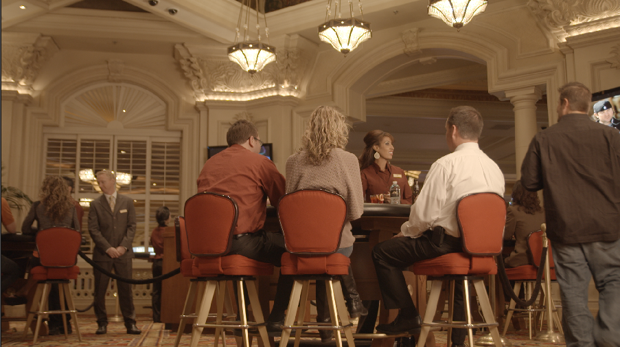

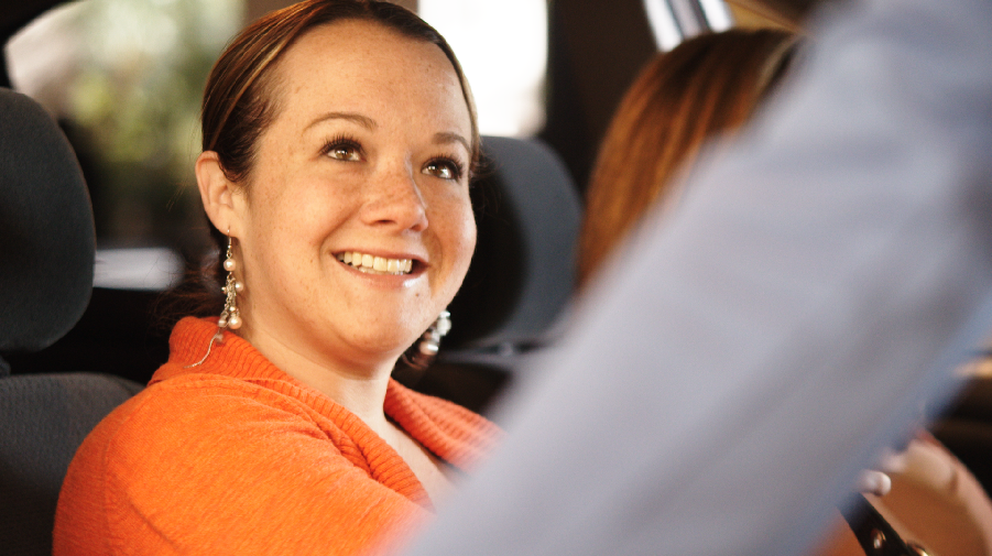

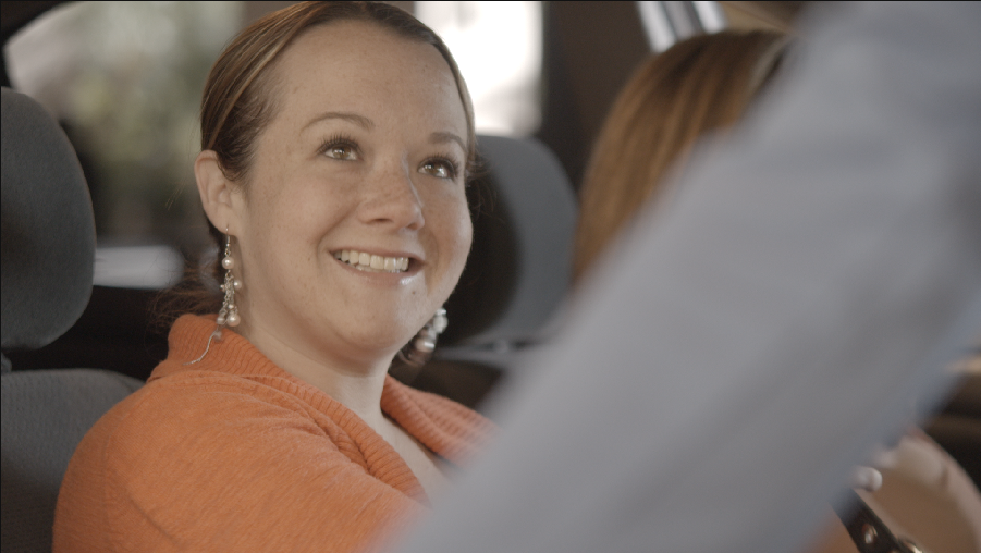

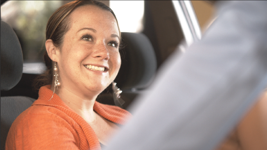

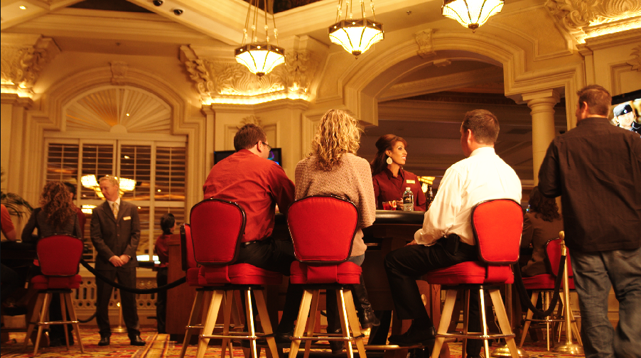

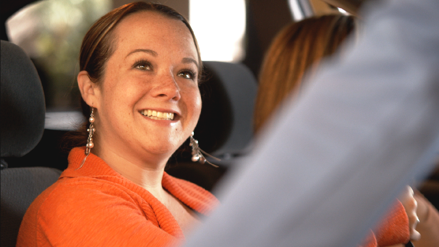

I can only go by my eye here. I downloaded Alister's Sony-derived .cube LUTs and made some stills in Resolve. I GREATLY prefer the Alexa LUT, but opinions, armpits, etc etc.
[crud. I uploaded all these stills with descriptive filenames so you could all see what's what, but the filenames are stripped off in posting. Make some guesses, and I'll repost a legend to the stills when I get back. Have to run!]
S-Log Sample, colored in Davinci-no-lut.png   S-Log Sample, colored in Davinci-alexa-log-c-lut.png
S-Log Sample, colored in Davinci-no-lut-2.png   S-Log Sample, colored in Davinci-alexa-log-c-lut-2.png
S-Log Sample, colored in Davinci-graded.png   S-Log Sample, colored in Davinci-sony-1d-lut-sat.png
