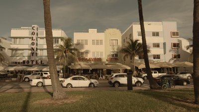

Just some stock footage I shot at South Beach for a seminar I'm teaching november. It was early in the morning with direct sun at about 15 degrees off of the horizon. Just look how smooth the transition from direct sun to the shadows inside the restaurants.

I think your overexposed by 1.5 to 2 stops. In the pre grade shot your bright walls are measuring out at over 80% and your mids look to be around 50-60%, white should be 65-68% and mids 34-38%. After grading your bright walls are clipped and blown out and have no texture or shading, especially on the upper left and the cars have that look that overexposed look that log gets where the high compression flattens the contrast giving the white cars an odd look. I think this would have looked even better with lower exposure. You could probably fix the blown out walls in the grade by de-logging the clip prior to grading or using a grading tool with log based corrections, but the cars will be hard to get looking right.

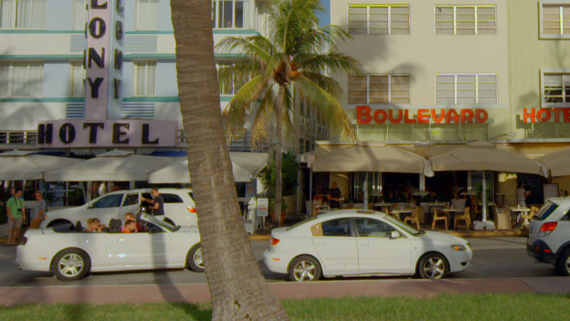

Are you for real?
You can shoot however you want. I shoot for the end results.
You care more about your waveform than the actual image. Just look at the brightest area in the shot, the white car in the middle. It clearly shows the door handles and even the curves on the doors even with detail off at such a long distance. It still has more, but that's the way white looks.

Well, my opinion is that your end results don't look good and are not a good example of how S-Log can look. It looks like the kind of clipped video you get with Rec709. I think that the shoot would have looked a lot better exposed lower. Your walls are blown out and the cars just don't look right. Of course that is just my opinion, perhaps this was the look you were after. The issue is that log is not linear. Expose too high and you crush your highlights making it hard to recover gradients and textures in the grade. Knowing your levels with log is important. I looked at your levels to try and diagnose why the image looks the way it does and it is my opinion that a lower exposure would have resulted in a better image.

Hi Leonard, I appreciate your comments. As you said, you were not there, or seen the original ProRes HQ footage. At least you started with a disclaimer. I'll provably post the same footage shot on a P2 simultaneously to have a reference in the class I am teaching in november if I can get to it.
My background is in photography. I have won multiple international awards (Back in the 80s). What you see is what I wanted to see.
All my tests were done the first week I got the S Log. vimeo.com/45609991
I know exactly its capabilities and how far I can push it. The test may not work for you, but it shows me how each f-stop over or under looks on real footage.
The white no texture surface that I saw with my eyes is just what you see on my Apple 27" LED, my Panasonic 21" monitor and a Pani 42" LED.
Blow the tiff pic attached of the pre-graded grab.
