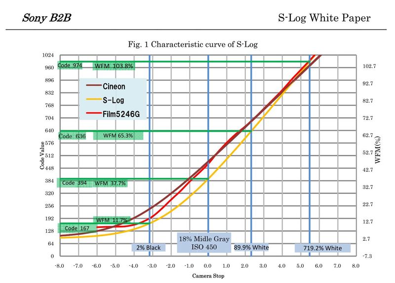

Re: SLOG ISO ratings?
That's a marketing slide that might be vaguely representative of the dynamic of S-Log range squashed into a rec709 display after grading. It's pretty meaningless.
This is from the Sony whitepaper. It's the F35, not F3 curve, but the concept is the same.
www.davidwilliams.com.au

Posts: 2,322
Stops are not a liner measurement so even if you are allocating equal luma steps to each stop you are actually compressing the info as the exposure goes up.
I've said nothing about stops being linear.
Various people have been asserting S-Log compresses highlights greater than regular gamma curves.
It's actually the reverse. S-Log gives you more room through relatively even numbers of bits allocated rather than reducing bits per stop as you near clipping.
David C. Williams is offline   Reply With Quote
While that slide is roughly analogous to S-Log displayed on a REC709 monitor, it's totally unrepresentative of the data actually recorded is S-Log, and easily misinterpreted, as shown in this thread.
Exposure isn't more critical in S-Log than regular gammas, it's actually more forgiving, and it doesn't compress highlights more than regular gammas, it compresses significantly less.
Regular gammas have a fat part of the bandwidth where skin tones work best, simply because skin has naturally very fine colour and luminance graduations. The fatter part of the gamma data curve gives a more realistic representation of skin. It doesn't look flat when exposed there, hence the old skin tone exposure rules.
S-Log has relatively even bandwidth spread over all stops, so skin can look natural almost anywhere in the spectrum. Now you can expose scenes as they look naturally to your eye if that's your aesthetic, and you don't end up with a flat dull grey faces in the dark or bright monotone under hard light.
