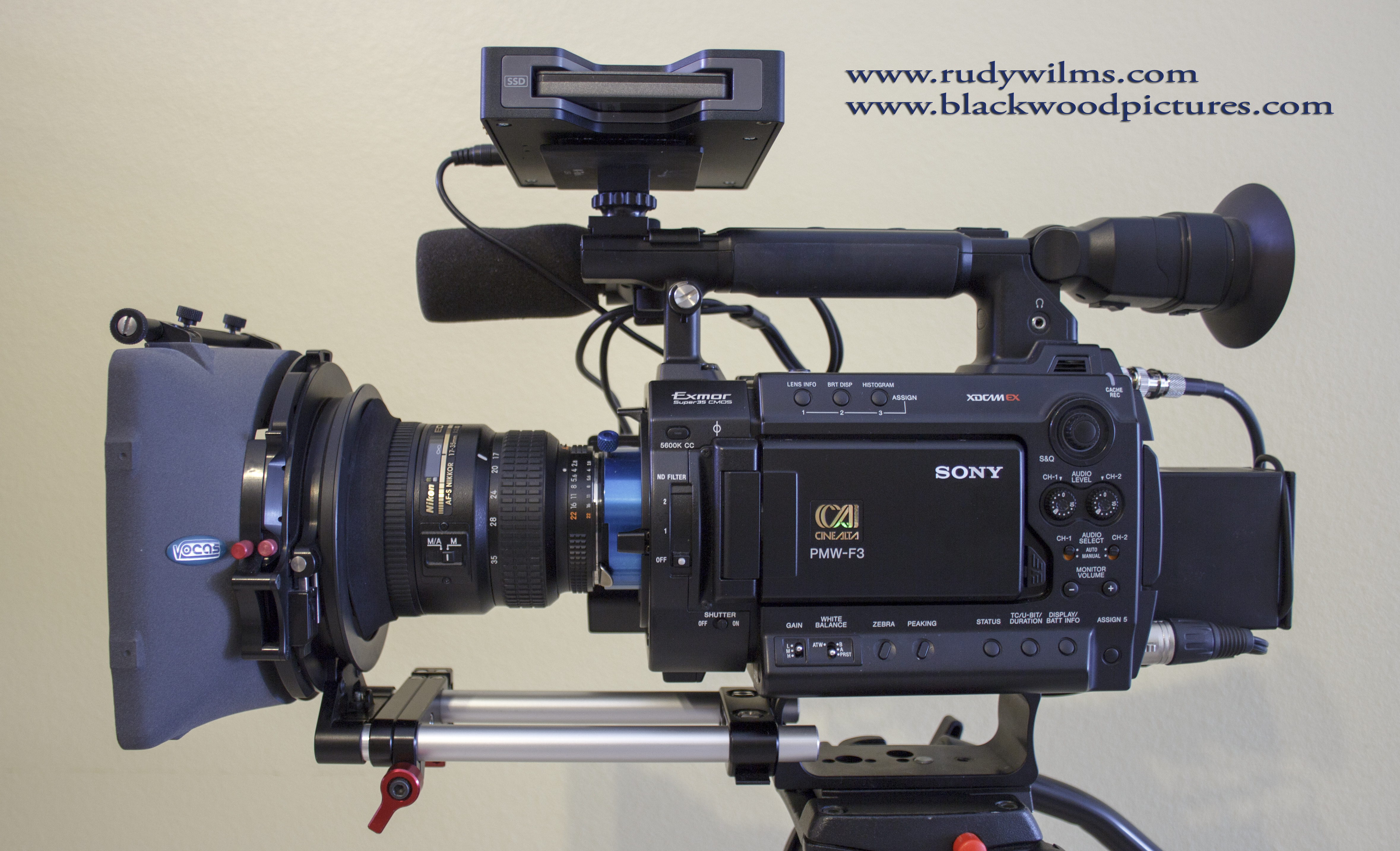

My Sony PMW-F3 with Hyperdeck Shuttle 2

Very nice, and I like the location of the shuttle!

Thanks Dennis I also prefer the SDI a for its location and the location of the shuttle wasn't my first choice but after trying it out I do like it now my next goal is to find out what to do with the 29.97i (wrapped psf) in editing
