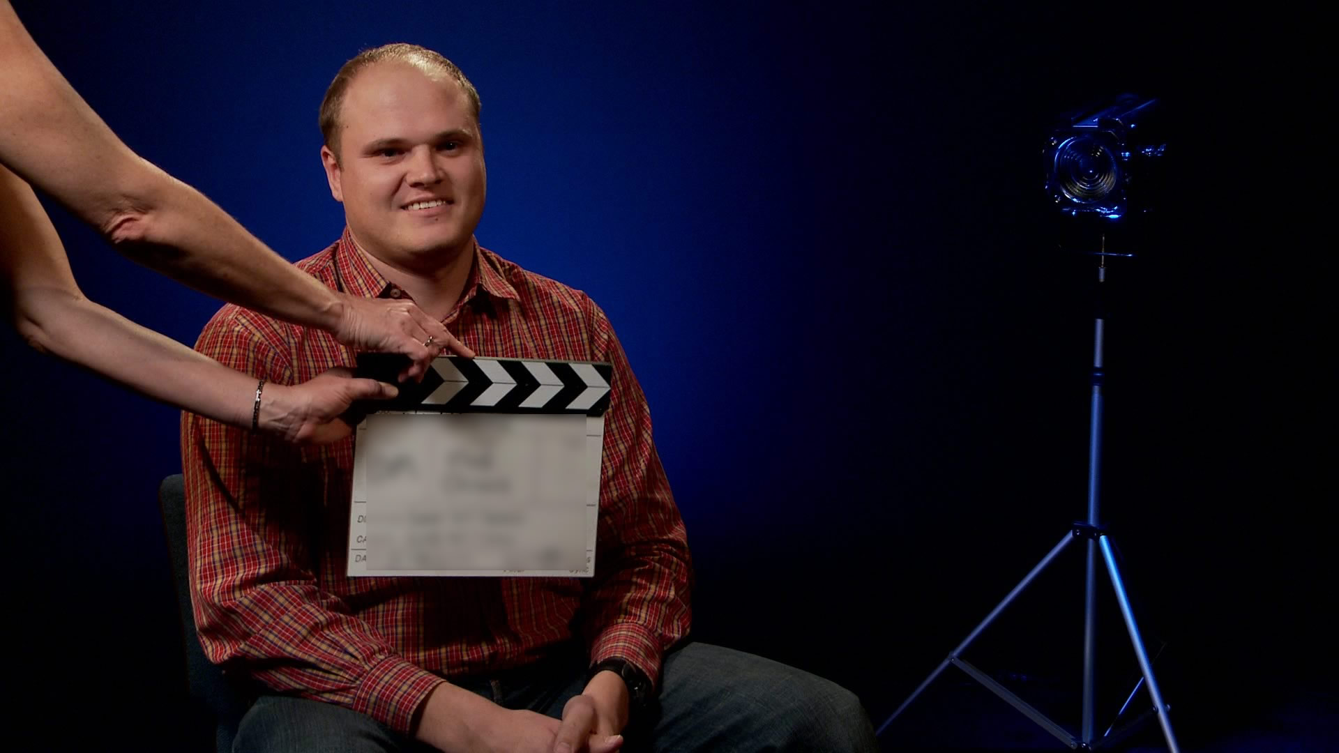

I have a small studio strictly for interviews that I want to equip with a cine camcorder. The F3 suits my XDCAM EX workflow so I'm thinking of picking up a second hand F3 and put on the MTF adapter for Nikon. How far from the subject do you find yourself setting up the F3 with a 50mm for something like the attached? 35mm?

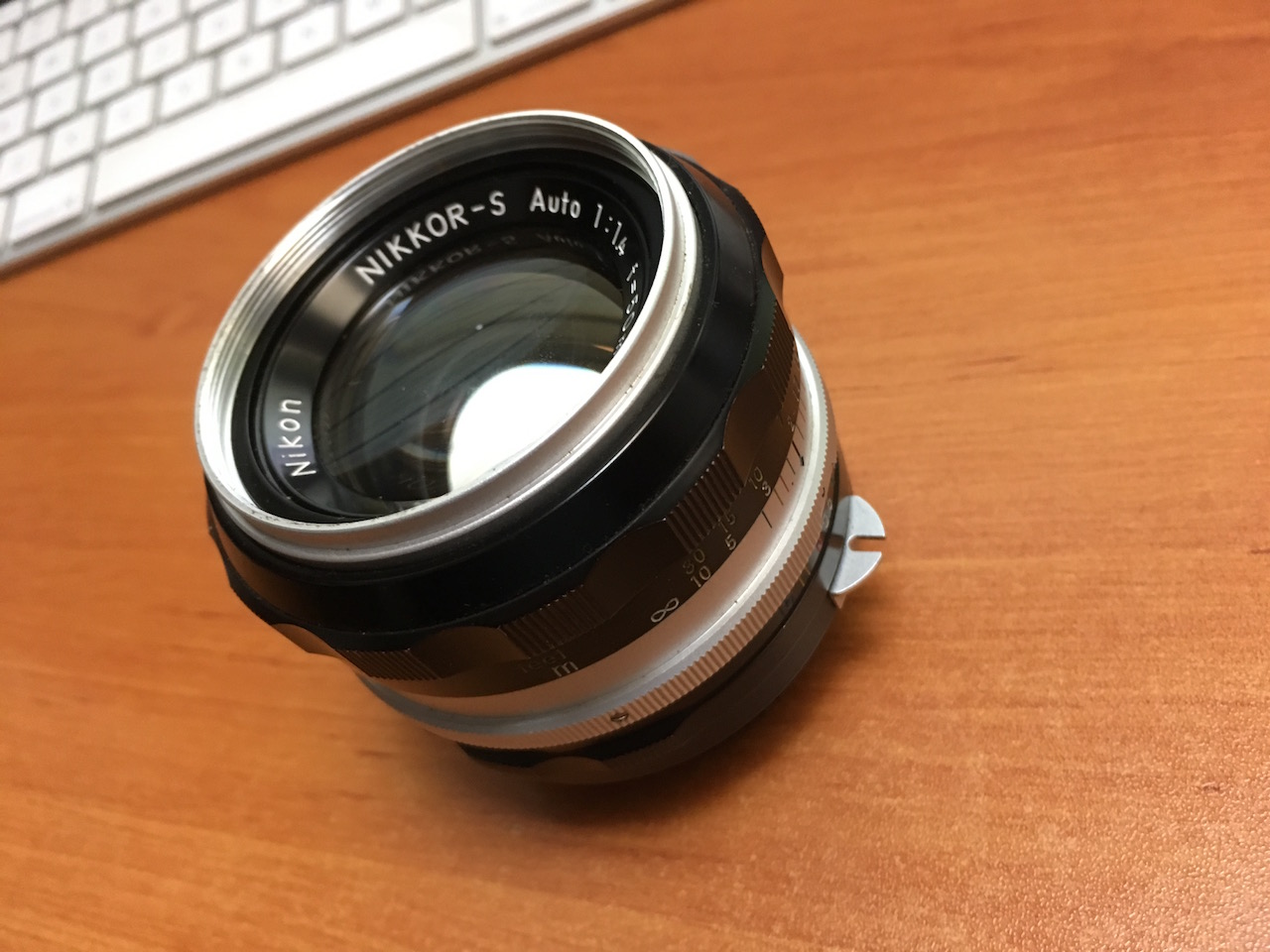

You are right. I see the shift. I picked up a Sony PL mount P50T20 and an F3 so this Nikkor lens goes back in the case. Also in the case is a Vivitar f3.5/28mm and 3.5mm/85-205mm glass from the same era.
Nothing's been used, de-clicked or cleaned for 30+ years. Given they are all manual, I'm thinking that for fun, I'd maybe pick up this inexpensive mechanical mount for the 28mm for outdoor stuff. I have no idea how well these old lenses resolve. Any thoughts on that and with these FotodioX adapters?

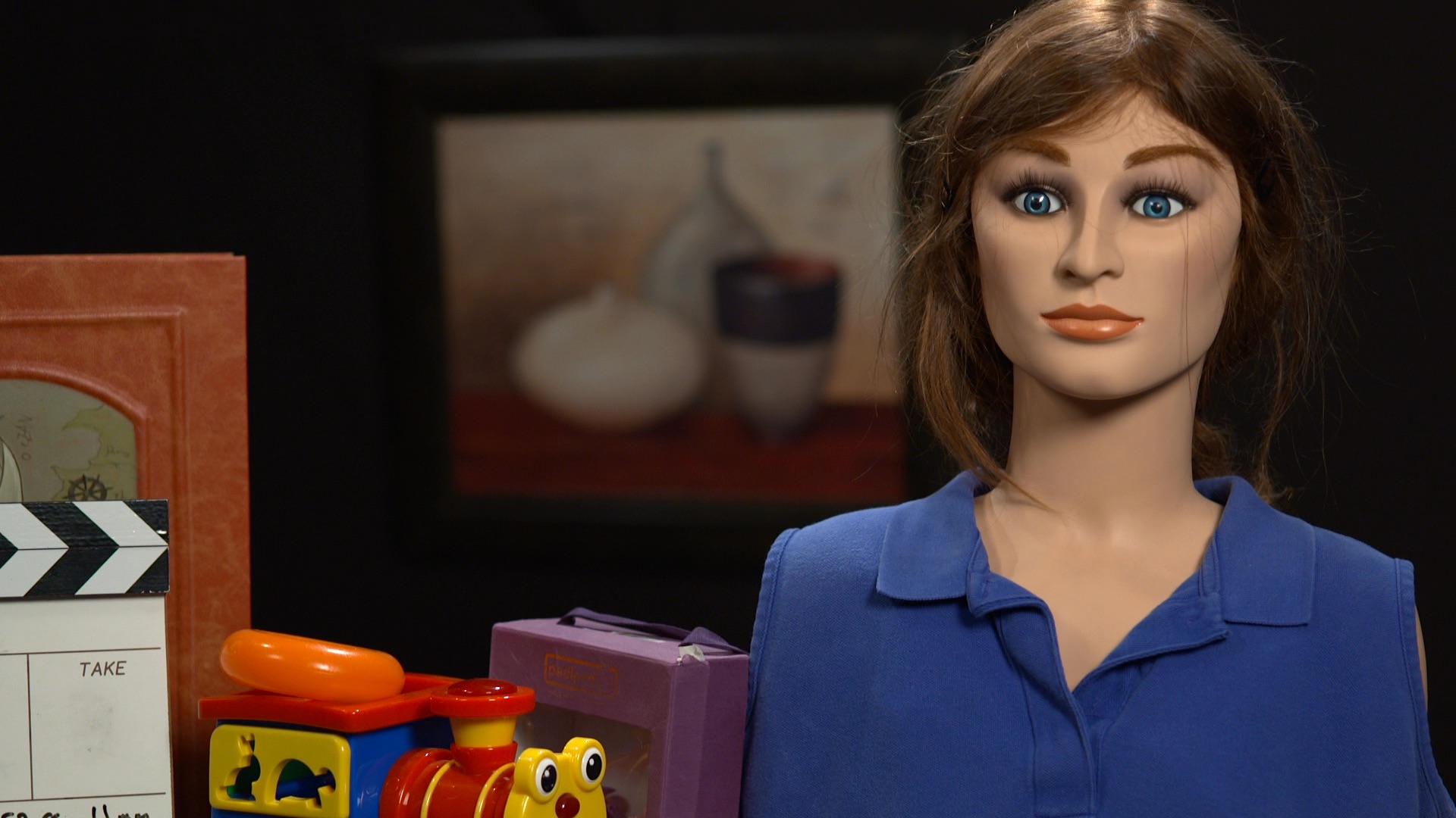

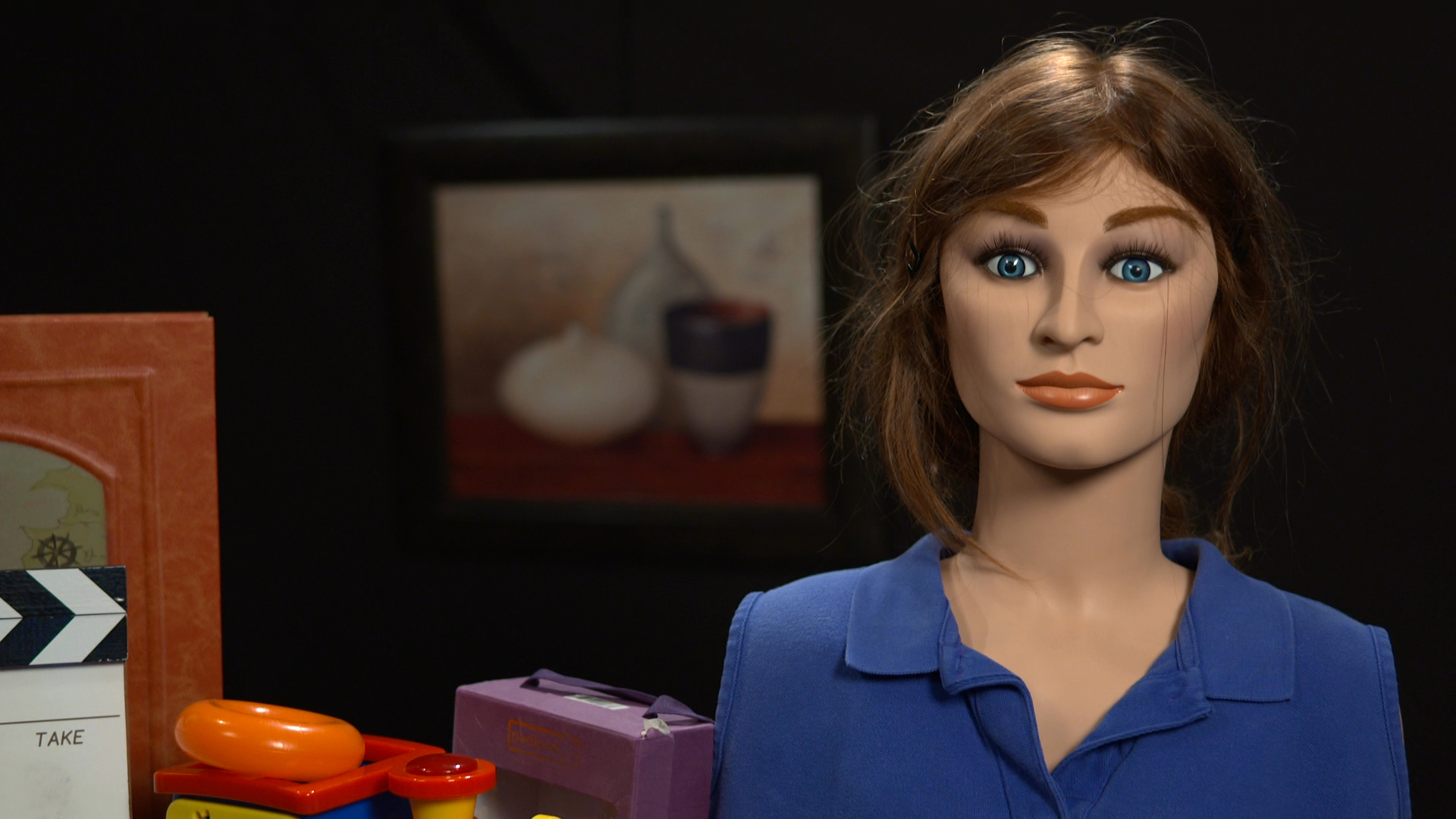

Just leaving some test result bread crumbs here. Nikon-FZ adapter has not arrived to test out Nikon/Vivitar lenses. However I did pickup Sony 35mm and 50mm PL primes on ebay and setup the same framing. 35mm is first attachment.
The 35mm is 3' and the 50mm is 5' from subject. Both lenses at T2.4. Pleasantly, the 35mm delivers decent bokeh for the same distance between subject and background but the FOV shrinks the background.

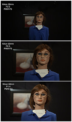

I got my FOtasy Nikon adapter. It was only $60 and in this case, you don't get what you pay for. THe adapter's alignment pin on the FZ side is too long and prevents the flanges from lining up. After removing it, the FZ end mounted but on the Nikon end, there was nothing that locked the adapter to my 70's era Nikon mount lenses. They easily unscrewed from the adapter when adjusting focus, iris or zoom. So I'm returning it. I did do some test shots.... plenty of breathing ... but that 50mm F1.4 would be wonderful but I don't know if I'll ever find an adapter that will work with it. Ideas?
