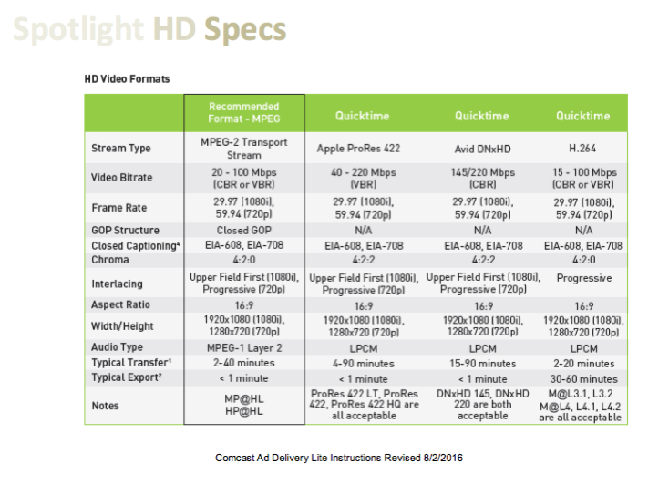

Camera and NLE are different last time I did one of these. I'm a little confused by the 1080i in brackets in the specs for a 30 second spot on Comcast. Is 1920/29.97p the best format to use on the F3 or should I shoot 720p? I'm using FCP X and it has a 720p, 1080p/29.97 and 1080i/29.97i timelines.
Recommendations?

1080i is INTERLACED video, 1080p is PROGRESSIVE. They are requesting 1080i. Shoot, edit, and deliver as 1080i then.
HD HQ mode: 1920 x 1080/59.94i

Thanks Jeff. I did some tests and found that the F3 60i had scan line artifacts when FCP X converted it to 30i. I shot at 30p and converted it to 30i no problem. Also shot a 720p safety.
