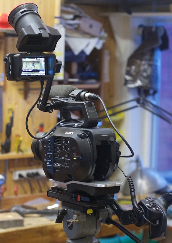

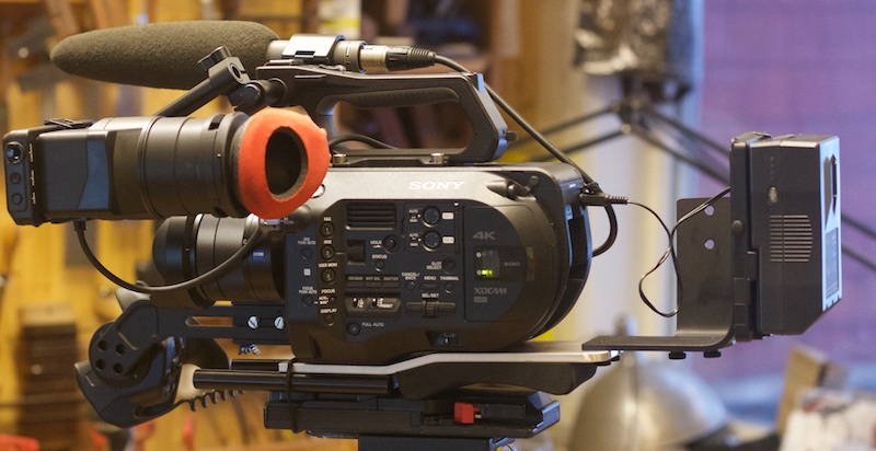

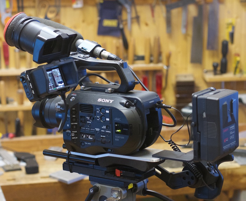

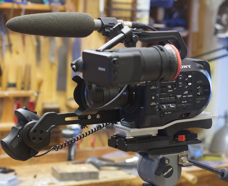

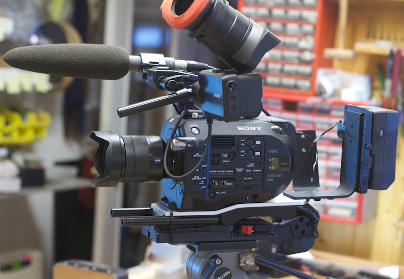

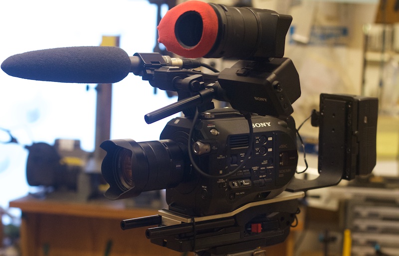

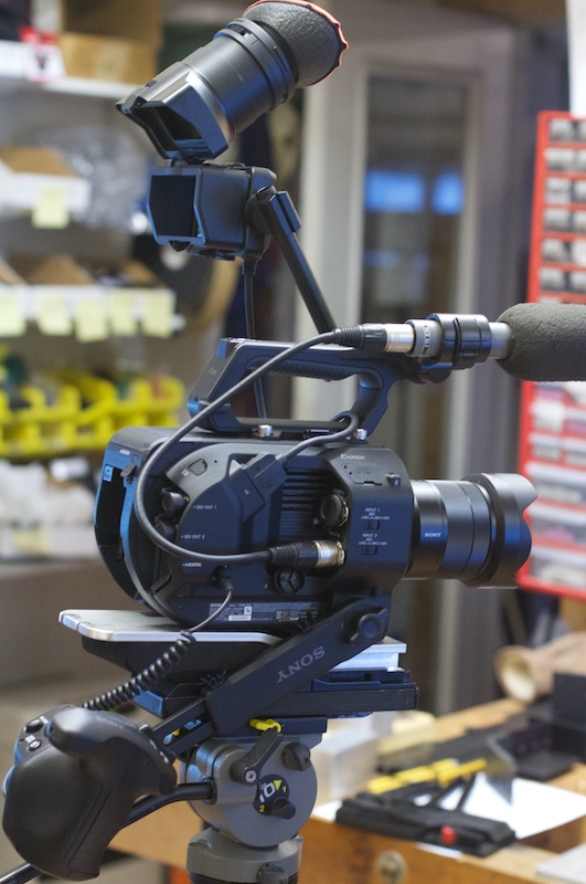

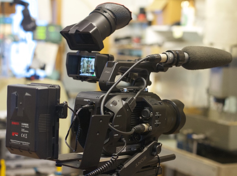

I have started to work on the FS7 Comfort kit.
I want it to be small and light but well balanced and comfortable as well as modular.
Here is the beginning. Basically a very solid bottom plate that attaches with 4 screws (2 where the Sony pad was). A much more padded shoulder pad. very simple 15mm rail mounting up front and in the back, or as in these photos my cheese plate with IDX, AB or even other battery plates. This really helps to balance the rig on the shoulder.
I don't like moving the whole camera too far back because then it is awkward to operate all the buttons and a small lens like the 14-70 f4 in these photos.
The extra wing on the back cheese plate is for wireless receivers or other accessories. Everything comes apart quickly with thumb screws like my other kits.
I will probably have a batch of beta versions back from the anodizer (black) on a week from Tuesday. Contact me if you are interested in a beta version at a good discount. The final kit will be priced similar to my FS700 and other kits.
Any comments are welcome.
Here are some quick and dirty photos in my shop at the end of the first day of development.

I am now on version 4. I am making the back shoulder piece separate from the front with the 15mm rods.
I can sell you one of the front pcs only, if you like. One of the nice things about my shoulder pc is that it attaches to the FS7 with an additional 3 screws. And that adds a lot of strength to the kit.
I am a little concerned with the 4 small screws that holds the ¼" and ⅜" attachment plate to the FS7.
I will post a photo here soon. My front plate can use either a VCT wedge or any QR plate there are 4 ¼" holes for these plates.
The price for just the front part will be $350.00

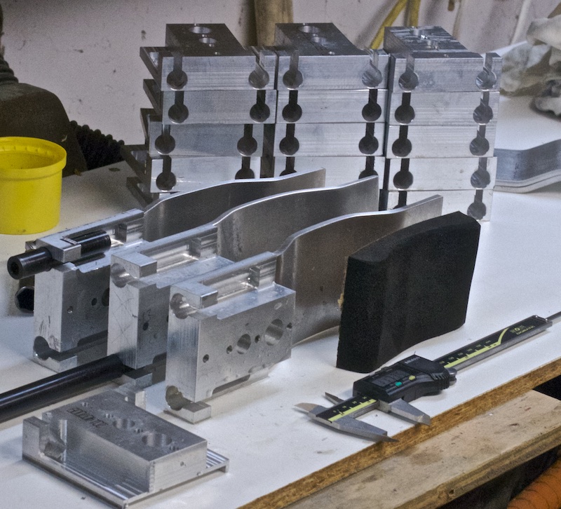

Here is a Photo the CNC mill is spitting out parts as I write. I should have the first batch ready anodized next week.
I will post shots of the assembled kit on the FS7 soon.
This kit will sell for $390.00 that includes 15mm rail clamps up front adjustable in and out 2". The Base can be shipped with VCT wedge or just with ¼" holes for any QR plate. There will also be 15mm Rail option for the back and an optional "TailHook" for using full size VCT-14 plates. I only use the front part (TA-100 from Canon), this saves a lot of weight on the sticks. The shoulder pad is 1" thick high density memory foam very comfortable.
One of the big feature in this kit is that the shoulder piece is attached with screws to the bottom of the camera, this adds tremendously to the strength of the kit. There are only 4 small screws holding the plate on the bottom of the FS7 to the camera itself. The EX1 and EX3 had similar design and a lot of shooters ripped the bottom out of their cameras, so I made a similar kit for those cameras.
I will also offer Brick battery either on rails or on the same style cheese plate as my FS700 kit.
You can preorder by emailing me if you want to be sure to get one of the first batch.
These are made in NH by me and anodized in Maine. Hand shaped and rounded for comfort. We sell direct so we can keep prices reasonable.
