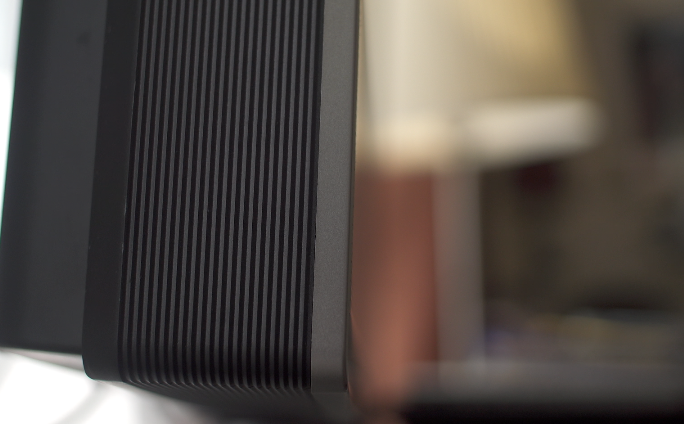

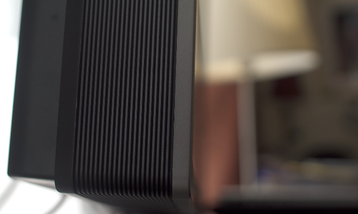

Originally Posted by Chad Johnson View Post
Hi Alfred. One thing that's cool about using a focal reducer like the Speedbooster Ultra is that it gives you one stop of light more, BUT the depth of field remains the same as the lens. So on my Sigma 24-105 f/4, I get the light of f/2.8 but my DOF remains at f/4. That's a really great thing!
Hi Chad. I've done some tests now and the DOF definitely changes with my Canon lenses I use with the Speedbooster. I strongly disagree with that statement. (If it carries any importance for people, well, that's another thing...)
Alfred Okocha is offline   Reply With Quote
Old April 14th, 2016, 06:54 AM   #52
Vortex Media
Location: Florida
Posts: 3,563
Re: Lenses for the FS5
Chad is correct. The depth of field is determined soley by the optics of the lens so adding a speedbooster or putting the lens on a camera that has a smaller sensor than full-frame does not change the lens. The lens is still the same lens. It may feel to you like the depth of field has changed because the the field of view has has changed -- but any change you think you see to the DoF is just an illusion.
Old April 14th, 2016, 08:29 AM   #53
Join Date: Feb 2004
Location: London
Posts: 427
Well, I know nothing about the maths but I'm sure the difference in these pictures are not imagined. Canons 40mm wide open and stopped down, to it's "normal" 2.8.
Lenses for the FS5-screen-shot-2016-04-14-15.45.43.png   Lenses for the FS5-screen-shot-2016-04-14-15.45.30.png
OK my bad fro not being more specific and exact. Apparently the DOF is made to be like a full frame camera, however the bokeh is not affected.
From the Metabones site:
How does Speed BoosterŪ affect the depth-of-field?
The short answer is Speed BoosterŪ on an APS-C sensor gives essentially the same depth-of-field effect as if a full-frame camera body were used.
The long answer is complicated. If we are referring to depth-of-field in the mathematical sense, that depends on the aperture, magnification and circle of confusion (CoC). Magnification in turn depends on distance and focal length. The 50mm lens now becomes a 35mm lens which behaves very differently in terms of perspective. The question is, do we still keep the distance the same? Should the CoC be kept the same? There are many missing variables we need to choose and fill-in before we could get a meaningful answer. When people claim Speed BoosterŪ does not change the depth-of-field, they usually neglect to state the implicit assumption that the distance is kept the same (thereby changing the object size) and the CoC is kept the same. The same logic would lead to the conclusion that an APS-C camera has the same depth-of-field as a full-frame camera, too, which under the same implicit assumptions is mathematically true (the depth-of-field formula is format-size-agnostic, after all), but with which many people would disagree from practical experience.
However, when most people ask about depth-of-field, they are not interested in mathematics, but rather, they are after a certain kind of shallow depth-of-field "look". If this is the case, the short answer above applies.
How does Speed BoosterŪ affect bokeh?
From practical experience, Speed BoosterŪ has negligible effect on bokeh. In most cases the resulting bokeh is that of the lens alone. Speed BoosterŪ does not leave its own "character" or "signature" in the pictures. It is very neutral.
http://www.metabones.com/article/of/faq
My Work: http://www.youtube.com/ChadWork1
