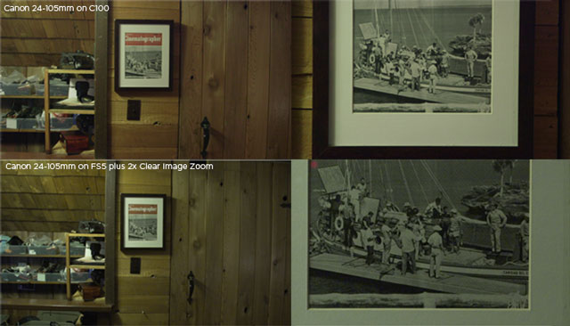

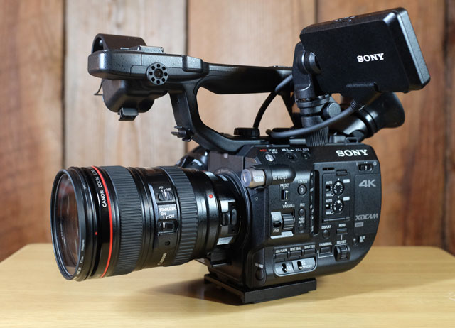

Just got the FS5 and Metabones Speedbooster (the "T" is the newest version, that's the difference). I've been using several C100's with the 17-55mm, 18-135mm, 24-105mm, Tokina 11-16mm, Canon 10-18mm, and other telephoto and specialty lenses. On the FS5, with the Speedbooster, the 24-105mm is king. It's a a match made in heaven.
The Speedbooster .7x will make the lens 17mm on the wide end, and with the Clear Image Zoom in HD (2x), it'll be a 147mm at the long end, (The actual 35mm equivalent will be different, but nevermind that). Plus f/2.8 with really good IS. So, an affordable 17-147mm f/2.8 IS lens - that's gold.
It also balances nicely and feels like a great fit to the FS5.
