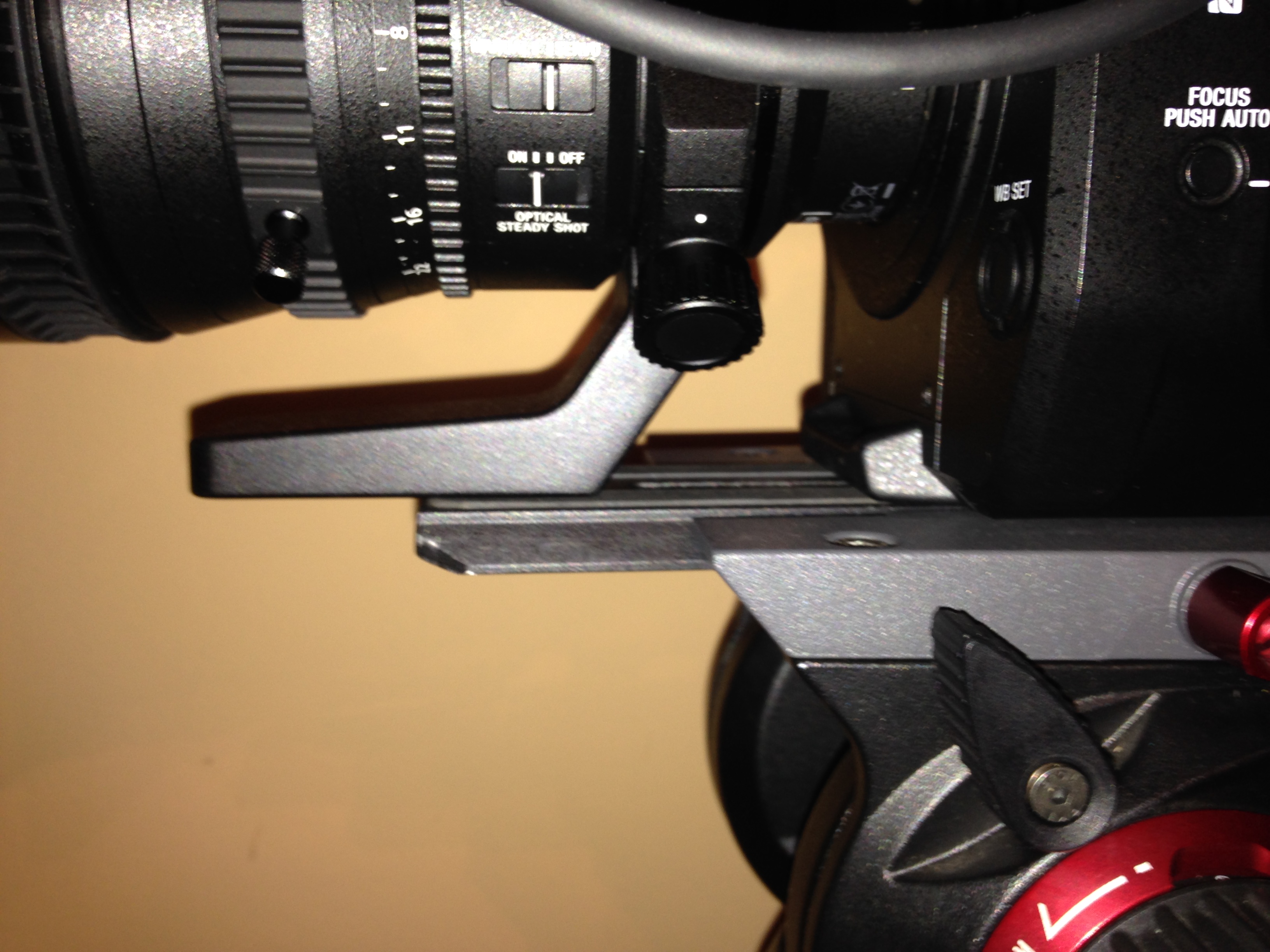

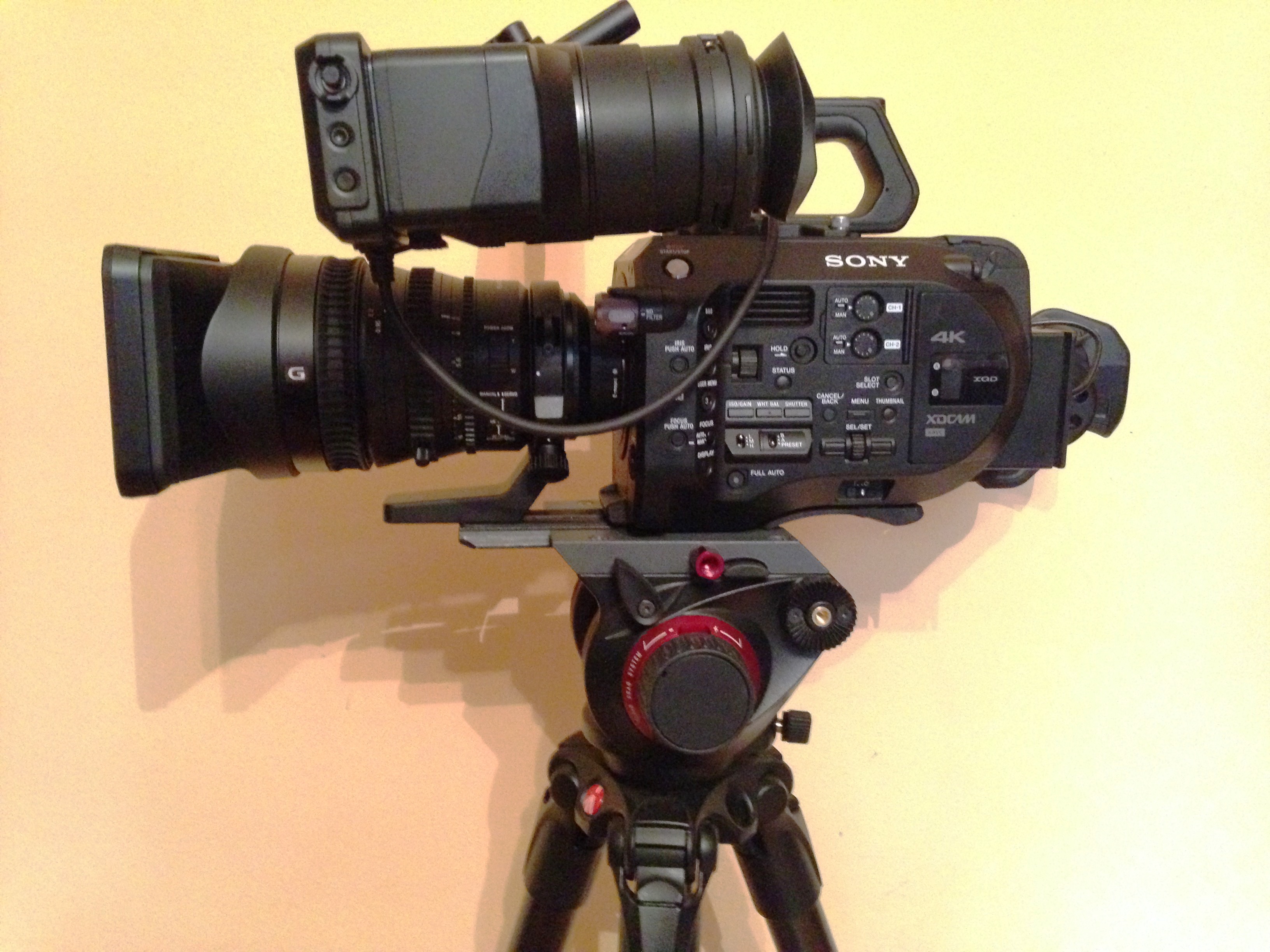

For those FS7K owners who are using the SELP28-135 lens: I realized the camera bottom and the lens leg are actually level and flush, so I just used the long Manfrotto plate and supported the two. Do yo think they (camera and lens) have been designed for the 2 surfaces I'm supporting to actually be at exactly the same level, and by doing so I'm not stressing the E-mount? I didn't fix the lens foot with any screw, so if there is any tension it only be acting upwards on the lens - but of course I wouldn't like that to replace the downward tension from the lens weight, acting on it when without any support... Please share your thoughts!
Of course, this is just a temporary measure before I get a rail system with a proper adjustable lens support....

On one hand a very impressive discovery! I have no doubt that this will help stabilize the lens mount.
However...
In looking at the lens and the location of the support 'foot' it's also obvious that most of the weight of the lens is out in front of where the support mounts on the lens, so in reality not that much of the lens weight is being supported. Thus your indication that you will be moving to a more traditional lens support system is definitely a good idea.
I find the lens collar support particularly useful when a small camera (such as the A7s) is mounted on the lens -- and then I attach the foot to a tripod or monopod mount.

This certainly is a temporary solution, but I don't think the problem is the lens is supported too close to the camera; my doubt is whether by doing this, I'm not applying an upward force on the lens, thus flexing the camera E-mount...

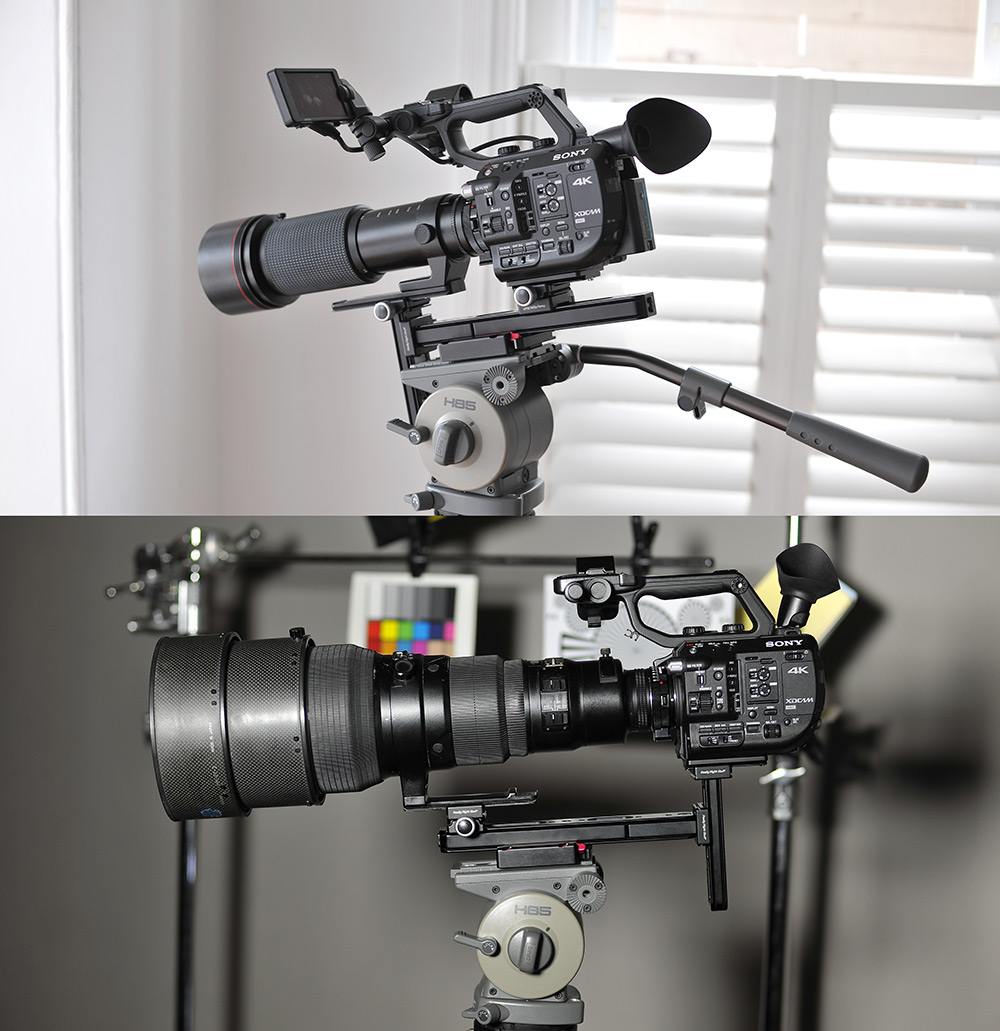

pretty slick (simple) discovery LOL as long as the plate has no flex its bomb proof and I can't imagine it has any especially at that short length. I also had concerns I am putting just as much upward pressure on the lens mount when using some of the "screw" into place lens supports so for smaller lenses (without a lens foot or when I need 15mm rods) I am going to use the Zacuto that will thread into the bottom of the Metabones adapter
The exact same idea for really large lenses set me back about $400 US, admittedly worth it as its huge relief knowing I wont damage another Sony lens mount. and its adjustable... just keep in mind any hight increase is going to increase the load on the fluid head a fair amount.
