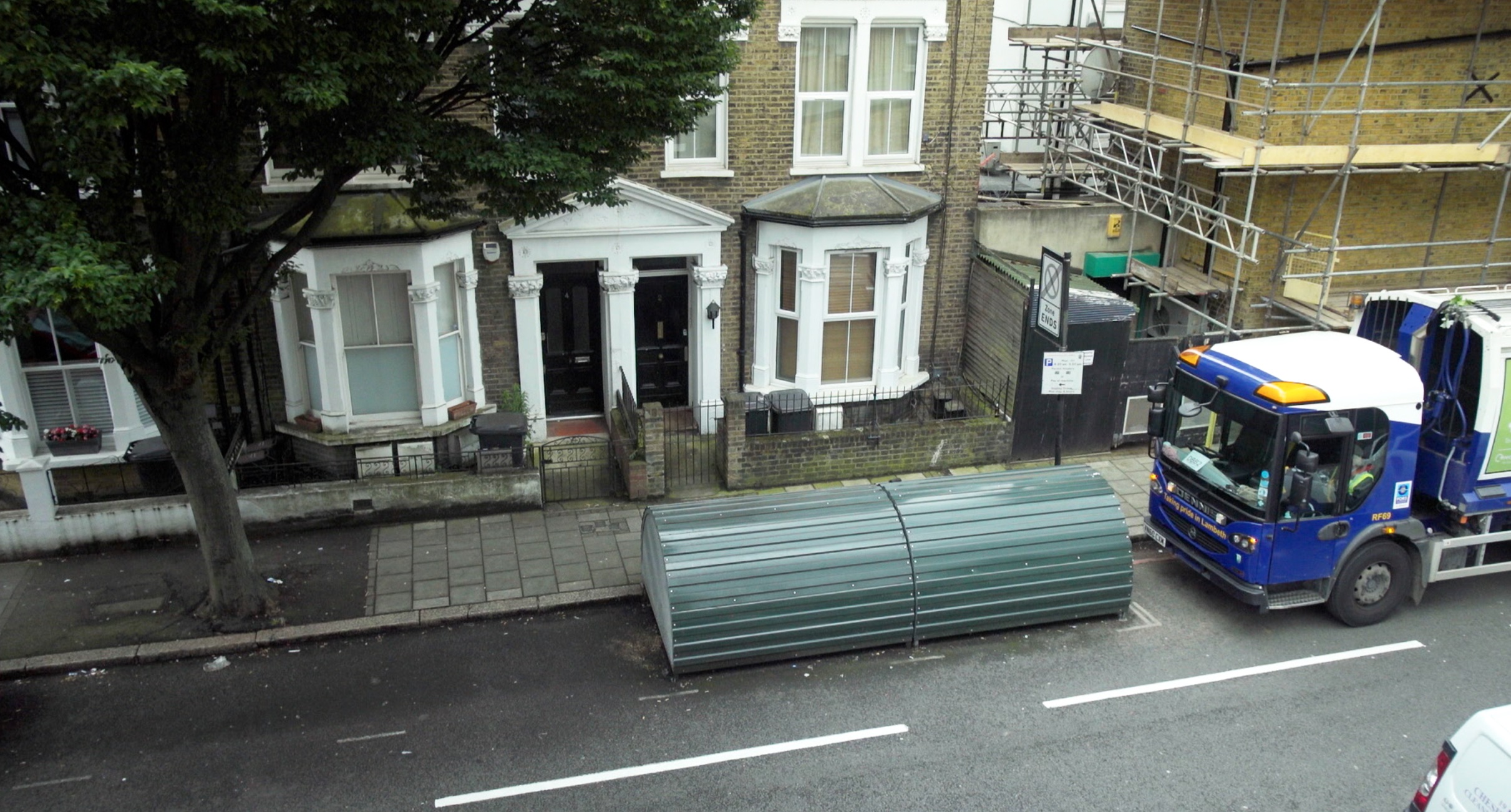

Hi there!
I just got a job for next week where I'll shoot s-log for the first time. (S-log 3 to be specific.) I won't grade it, they'll have experienced people for that. I just want to know I get the exposure right.
I just went out and shot some seconds using Dougs third rule up there. I applied the pre made SONY s-log 3 in FCPX and the exposure looks quite right. (I brought down the highlights a little notch since they were a bit over 100%)
1. Is it really that simple? (Considering all the warnings everywhere about shooting it.)
2. What should the zebra 1 be set at for skin tones?
3. They want some shots at late evening. Any tips?
Thank you very much!

Here's a screen shot by the way.

Re: FS5 S-log tips and gotchas
None. You don't expose for skin tones because everyone's face is different.
