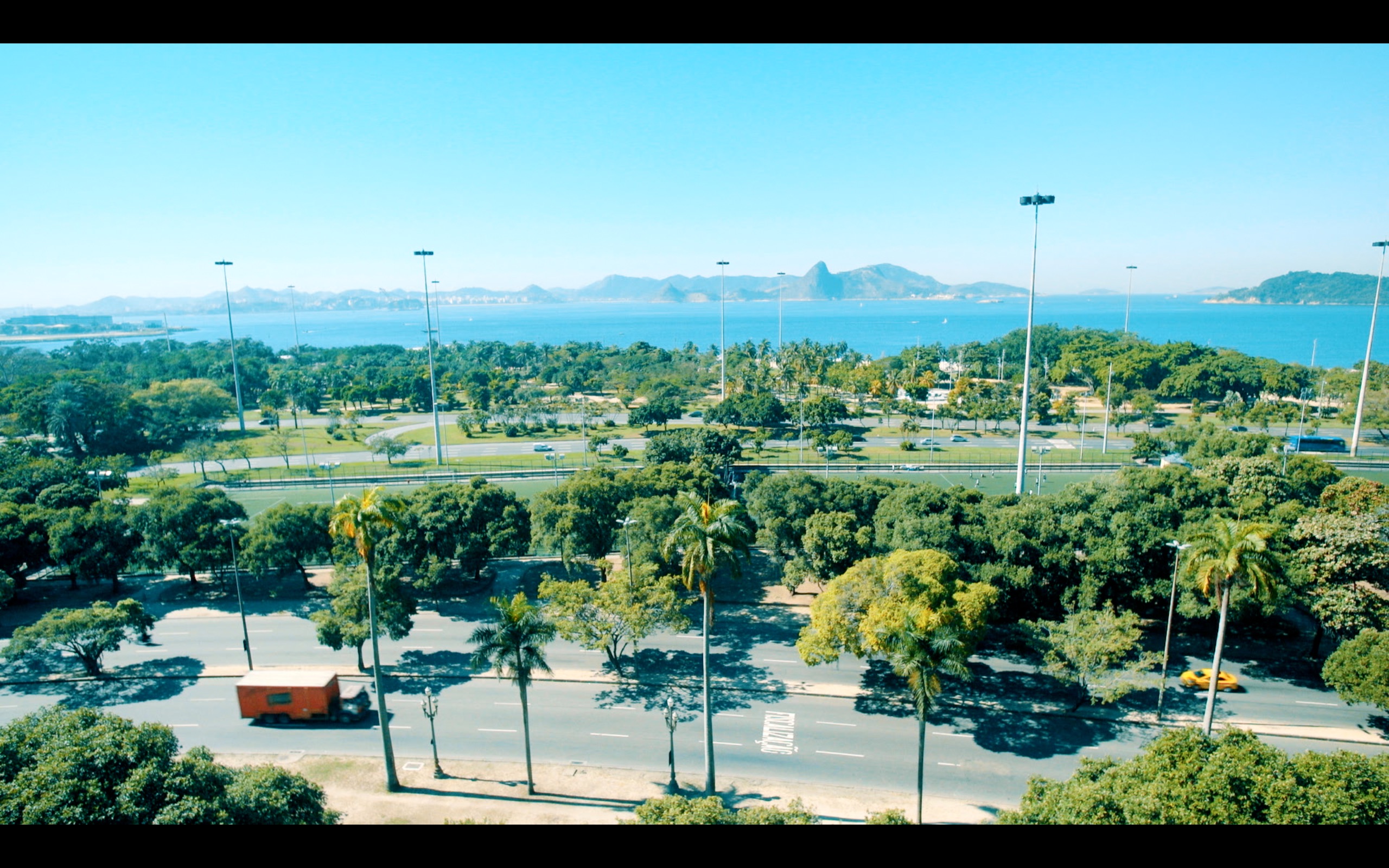

After some more testing it seems that skin tones is a lot trickier than a general view image.
Since I'm a grading dummy I just tried to do some basic grading to see what could come out of it. Is this a valid way of testing, does it give a grading expert an idea what he has to work with? I did the following; I imported in FCPX applied an osiris log LUT and expanded contrast until the whole spectrum was filled and then cranked up the colours a bit.
I realise that the end result in it self is questionable but if you had this image, could you work with it in a proper way?

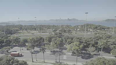

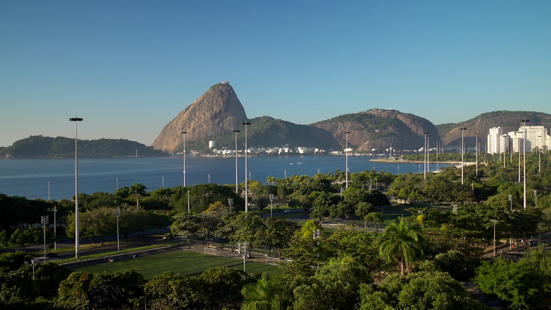

Not sure if these will do but...
FS5 S-log tips and gotchas-slog3-test.jpg   FS5 S-log tips and gotchas-rec709-test.jpg

So I grabbed your frame and did a quick grade on it. I didn't use any LUTs, just high, mid and low color wheels, AAV color lab and a touch of sharpening. In AAV, I adjusted green channel saturation and shifted slightly in the blue direction and darkened yellows a bit. Mid tone color wheel was swung a bit towards red and overall saturation increased allot.
It's just a simple, plain "mild" look, I think with a modest contrast. Nothing at all special. It's not broadcast legal 16-235, there is some that dips under 0 but who cares for this? hehe
This one is has less contrast with lighter shadows:
https://drive.google.com/file/d/0B_6...ew?usp=sharing
This one has more contrast with more crushed blacks: (center of contrast lowered)
https://drive.google.com/open?id=0B_...GF4VGI0YkhfZkE
This last one has a LUT and has bold contrast. I kept this one basically between 0 and 100
Another with more contrast and blue water pulled back:

Nice work Cliff!
I'm partial to high contrast so I liked the last one best but the others are nice too!
I guess you had all the data you needed within the frame then, so I guess I got the exposure right for this one?
