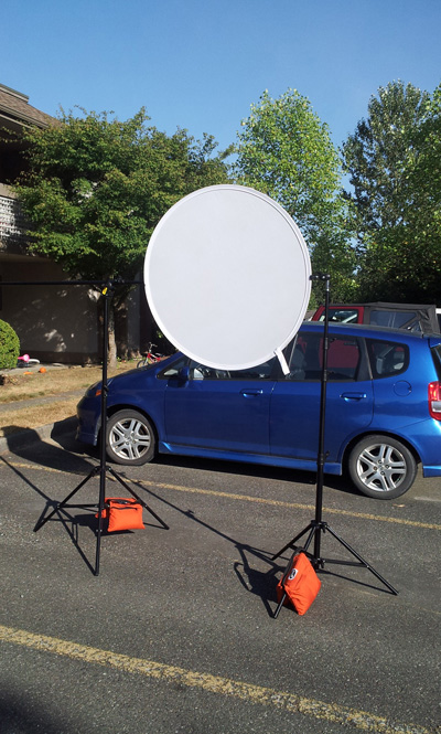

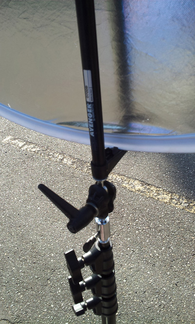

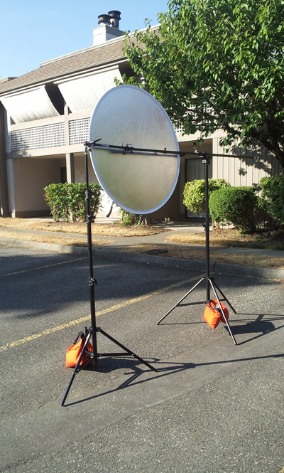

#4: Use two light stands and a reflector holder. I have a Manfrotto spring-loaded holder that works pretty well. It’s not totally secure as you’re relying on the springs to hold it in place. To keep the wind from catching it I sometimes use another light stand with a convertible boom arm (Manfrotto 3398B) and secure them together. (See photos) Add some sandbags and it’s pretty solid. You can adjust the height of the reflector and change its angle. Takes time to set up and not easy to move. But as a solo shooter I know it’s not going to fly away.

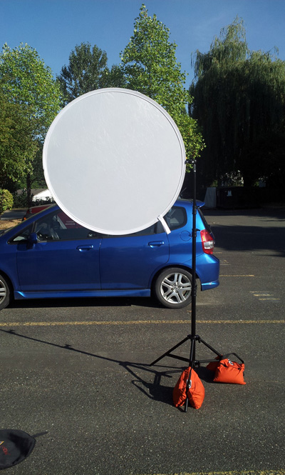

#5 : If there’s no wind at all, you can use the reflector-holder without any extra support. But if some wind comes up and blows it over, you won’t impress your client. And it doesn't take much wind to wreck your setup.

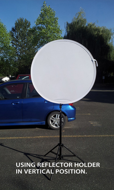

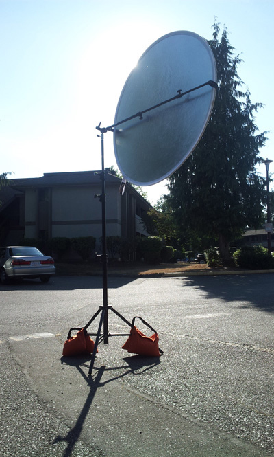

#6: While I was taking these pictures I realized that I could use the reflector-holder vertically, and just use one light stand with some sandbags. Makes it a lot easier to set up, but you’re pretty much stuck with it being vertical. Could find a way to use zip ties to secure the disc to the holder.

SPC: Using reflectors outdoors-r1-sandbags.jpg   SPC: Using reflectors outdoors-two-ls-sb.jpg
SPC: Using reflectors outdoors-two-ls-rear.jpg   SPC: Using reflectors outdoors-1-ls-sb-rear.jpg
SPC: Using reflectors outdoors-r-vert-no-sb.jpg   SPC: Using reflectors outdoors-r-vert-cu.jpg
