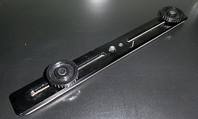

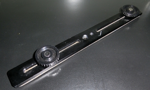

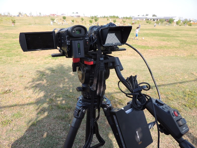

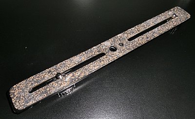

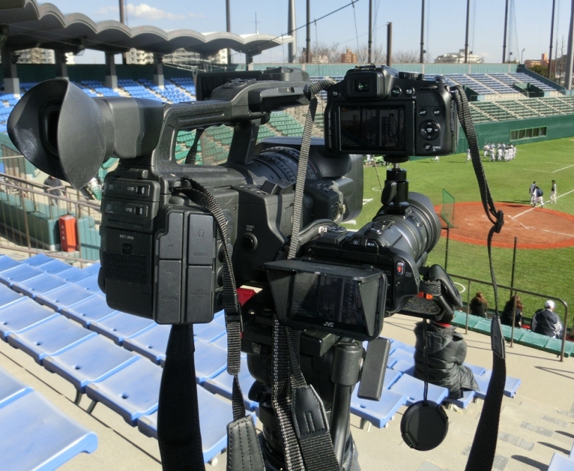

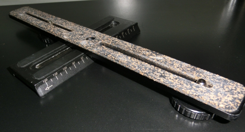

Two or sometimes three cameras on a single tripod.
2 camera's on one tripod-1-double-mount-bar-top.jpg   2 camera's on one tripod-2-double-mount-bar-bottom.jpg
2 camera's on one tripod-3-double-mount-bar-sachtler-plate.jpg   2 camera's on one tripod-4-double-mount-bar-cameras.jpg
