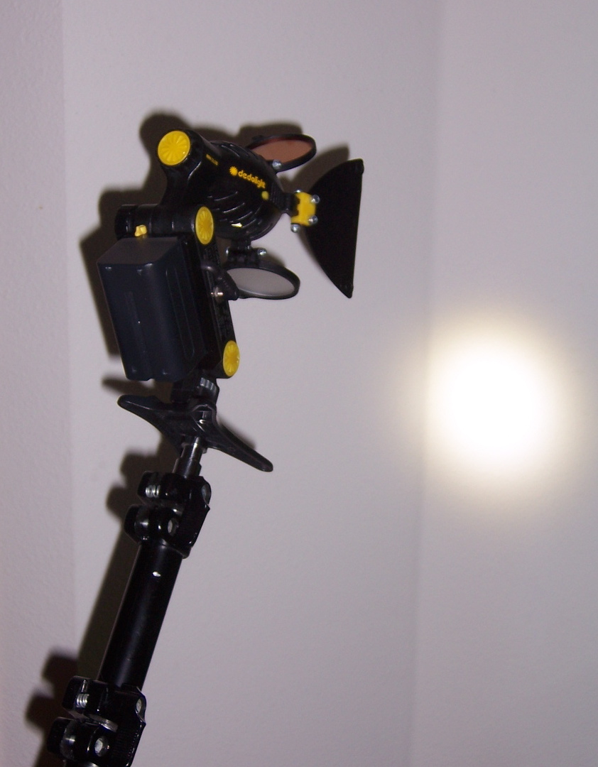

As a comparison with the above, check out the new Dedo LEDZILLA (called the LEDZILLA2) light. The "2" version is spec'ed out at 30% more output and improved CRI than it's predecessor. Primary use would be for a hair light but because the focus is adjustable it might be helpful as a flood, albeit not as powerful as the big lights. It's available with various battery mount options, including the Sony battery.
A store in Germany, Marcotec, has it for €265,00 + something like maybe €49 (depending on shipping weight) for shipping. Dedolight Ledzilla 2 DLOBML2 camera light Daylight - AF Marcotec Onlineshop Battery plate and accessories extra.
Picture below is of my original generation (pre "2"):
