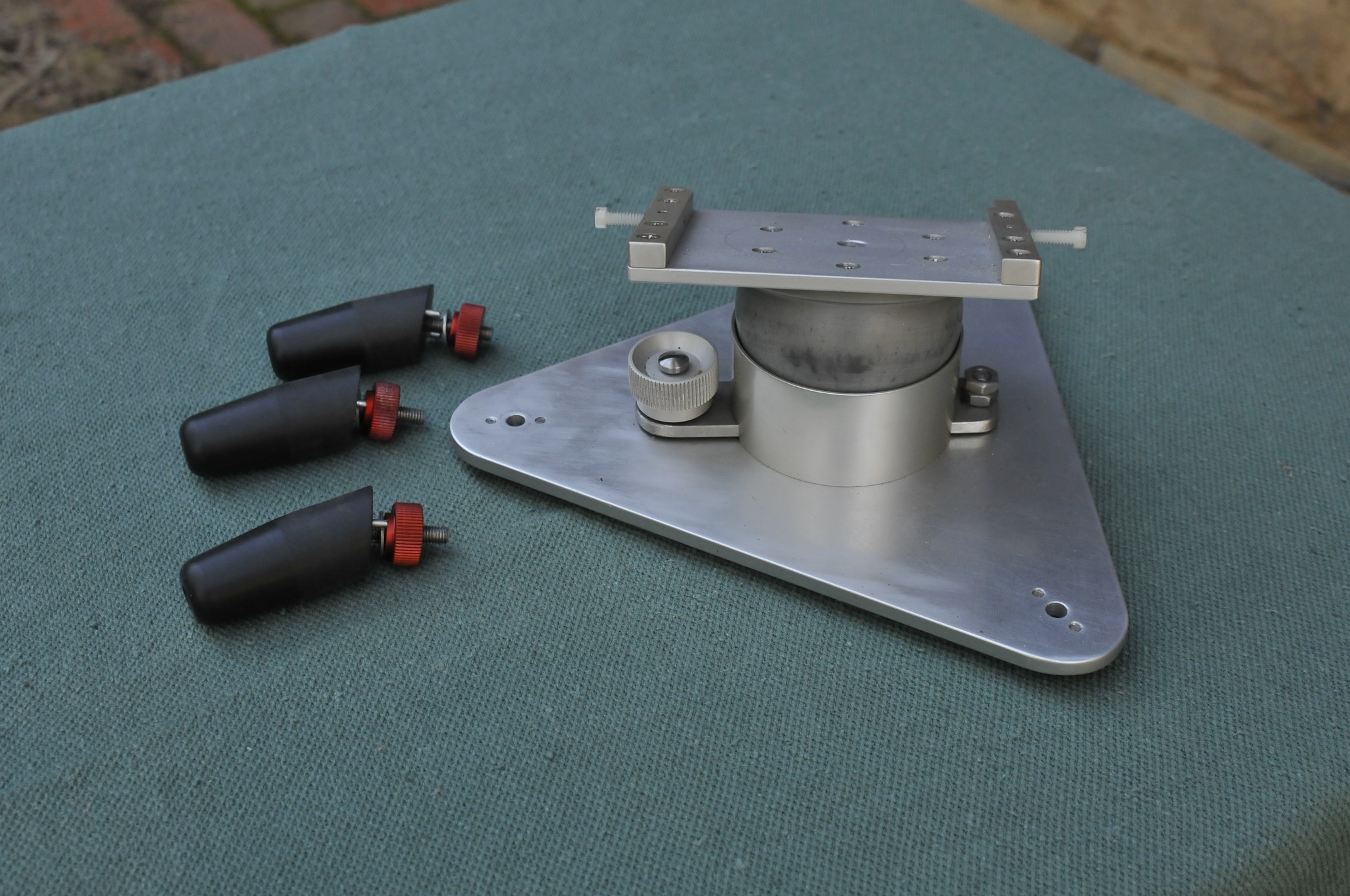

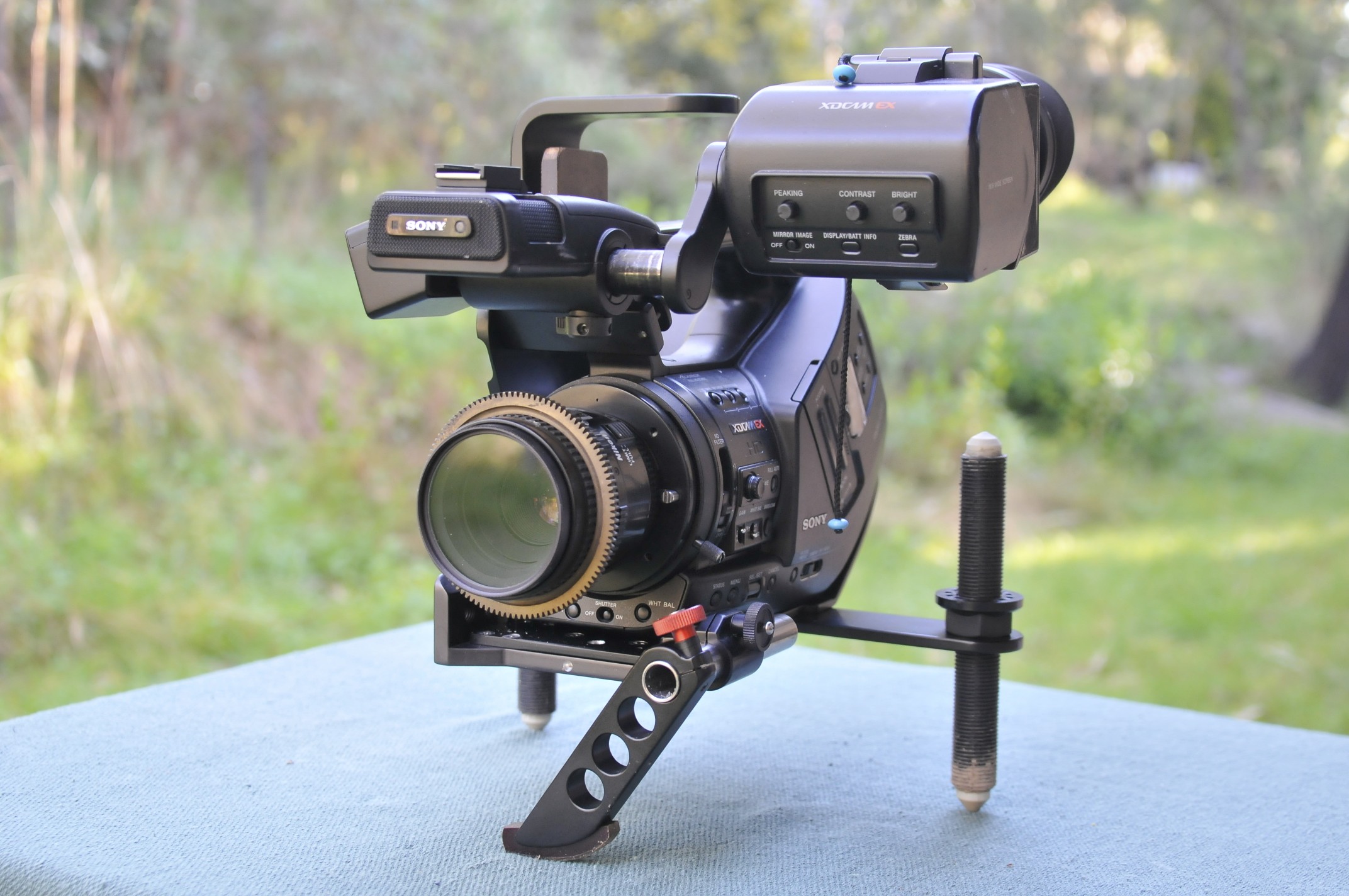

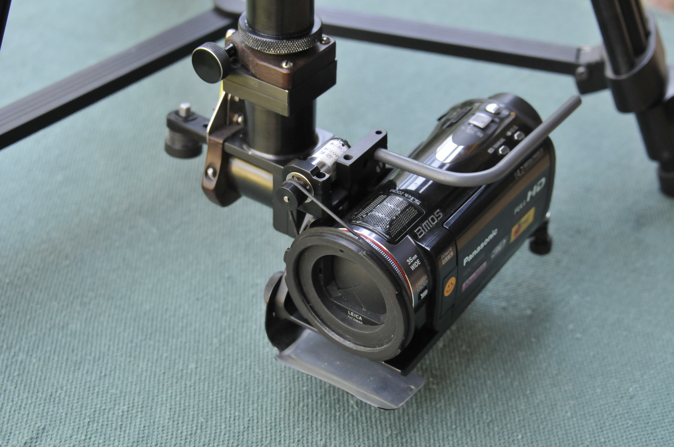

Hi Bob,
I have been experimenting with various ideas for low-level work – close-ups in particular.
The obvious off the shelf answer is a high hat. For my interest a high hat is too high but I found with a bit of redesigning I could place the locking knob to the side (see photo) instead of underneath which saved me some height. If you were working on level surfaces you could forget the ball leveler and bolt the head directly to a plate instead. Note the set of legs that can be added one by one if needed to the existing 6 mm legs. The unit is light enough to leave attached to the camera and is very easy to use for relatively wide static shots. However it is very tedious to use for any sort of macro work.
Another picture shows a set off legs attached to an EX3. The rear legs are made from a length of threaded pipe as used by plumbers. The front legs swivels on the single lens support rod to provide height adjustment. Although hard to adjust quickly fine control is vey good. An improvement for work on soft soil or sand is to place the legs in “saucers” – push on plumbers end caps work well.
For low-level work using pan and tilt a nodal head is ideal but the downside is that the head has to be supported from above.
