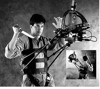

It doesnt need to be as rugged as the one below. I plan to use my Sony A1 with it. It is purely for mcu of the person walking around.

The picture Phil posted is the Doggiecam Bodymount, which is intended to fix the actor in the frame as they move through the set, very specific look that is different than tracking them with a Steadicam or other device. It's been used to great effect in many music videos, features etc. "Requiem for a Dream" comes to mind.
Bob is referring to a device most commonly known as the Easyrig, which suspends the camera off the operator. It doesn't purport to stabilize it, rather redistribute the weight. I have used a beefier version of this called the Suspender, which uses the excellent Klassen backmounted harness which I own for Steadicam work. Note that Klassen also has a version of the Doggymount concept called the Far Out.
Of course, all of these systems are built for the rigors of 35mm cameras--making something for the A1 would be much easier and lighterweight, and the integrity of the bodymount itself would not have to be as thought out--but keep in mind there is always a concern that the actor can swing around and stop too quickly and the resulting force could wrench their back.

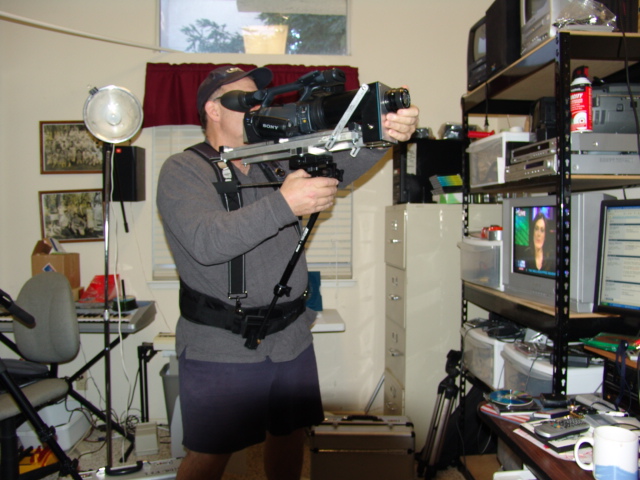

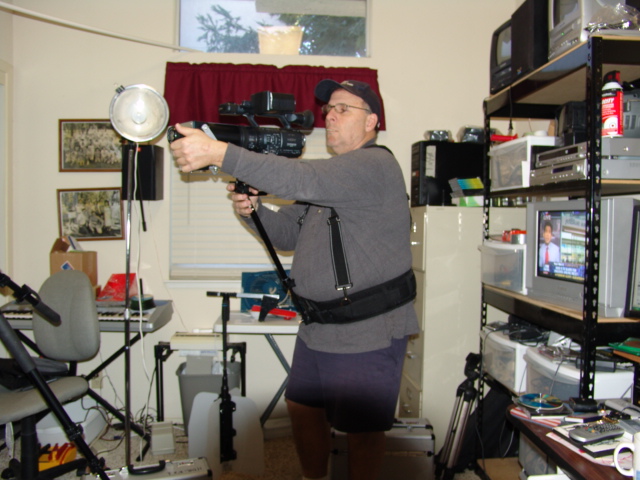

I have been messing with something to help me hand hold my home made DIY 35mm adapter that might work in reverse. I bought a cheap Steady Stick from BH for $99 and combined it, using the belt that came with it, with a "DeadOn" tool belt with suspenders I bought for about $60.00 from the local hardward store. Actually helps stabilize shooting so I can shoot with my contraption.
I am sure with learning to walk the "walk" it should act as a simple stablizier, though wouldn't ever consider it a replacement for a stabilizer system.
See pictures below, but ignore the fat guy....

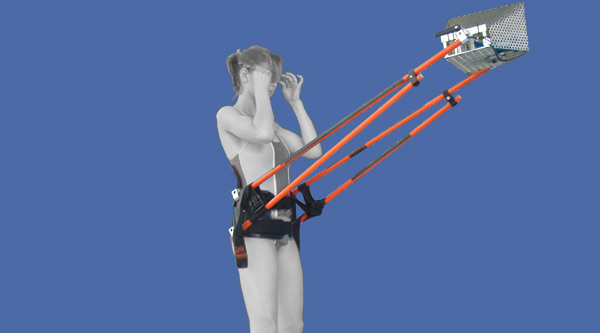

Hi Giroud, thanks for your answer. I was more or less thinking of a system like this one. It uses some kind of hip harness and aluminium tubes, I guess.
Mechanically it's not so hard to built I think, but I don't have any time or patience, so I'm looking for someone who can make me one.
