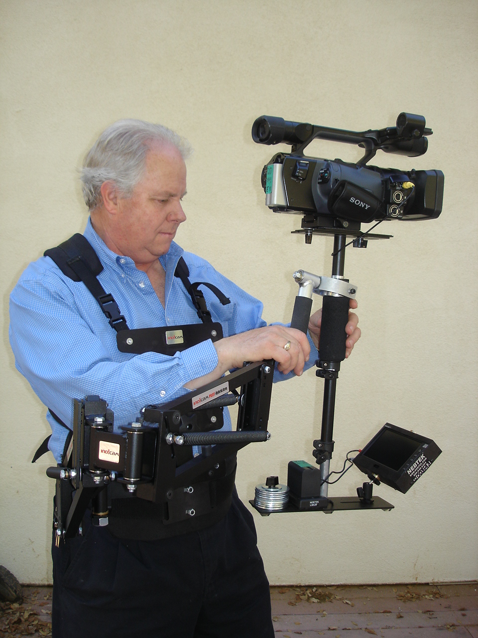

Hi Terry, could u provide a photo of the top post for the connections to the monitor. Thks.
Old April 1st, 2008, 12:39 AM   #23
Join Date: Aug 2004
Location: Auburn, CA
Posts: 578
Sean,
We just drilled a small hole in the top and bottom of the post and fished a thin coax cable through. We made sure there was extra inside (coiled if possible) so the bottom extension could be used if needed.
You have to solder the bottom phono plug after fishing it through the post.
Attached is a picture of one of our test set-ups. You can see the cable coming out of the post near the top and then plugged into the camera.
Hope this helps. I still prefer the built-in side mounted monitor myself though.
