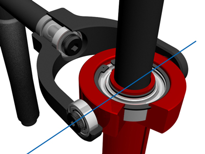

I bought a Flycam Pro 5000 (without any accesories) from a local dealer in my country (Romania). Well... at a first glance I'd say that everything it's working as Indian manufacturer of this unit says: nice and smooth. But there is a problem: after I balance the unit with my camcorder mounted ( XM2 + high capacity battery + wide angle converter - pretty heavy :-) ), I pick up the flycam with (let's say) my right hand and everything is fine. But if I grab the unit (by it's handle) with the other hand - let's say left hand - and the handle is oriented now to the left side of the main pole, the balance is broken. And so, I can't perfectly rotate the camcorder around the main pole axis, it's moving like a pendulum.
I rather say that the Flycam 5000 "precision manufactured" gimble is not so precise. I mean the line between the 2 screws is not the same with the ball bearing diameter.
My question is if other people met the same problem with similar stabilisation units? I mean could it be an accident and only my flycam has this problem? Maybe during transportation something occured...
I guess these days I'll go back to the dealer and try another unit. If it has the same issue well... that's right "you get what you pay for".

That is a sign the unit wasn't machined precise enough. My glidecam has the same problem. Turned one way its in balance, turn it the other way (or change hands) and the static balance is off. It makes panning shots more difficult.

sigh...the ONLY real moving part on a stabilizer is the gimbal (plus the arm if applicable), and if that is built incorrectly, ya got problems.
Perhaps this can serve as a counterpoint to those who dismiss the Steadicam brand products as too expensive as they feel they are "paying for the name". On the less expensive side, Indicam takes pains to make sure their gimbals are as linear as possible also.

Yes, bad news for my Active Industries flycam. I went to my local dealer (finally) and I tried (the) other unit available. I balanced my camcorder but it happend the same thing: when I changed hands on handle, the balance is broken, even worse than first flycam unit. The dealer motivated that it might have be some "secret recipe" to correctly balance a flycam and he is not a specialist and he can't help me. Anyway, he admitted my demonstration that the unit shouldn't get into pendulum motion when spinning around ballbearing's axis and returned my money back.
At the and of this month he will bring Glidecam 2000 from US. I'll try one of these too. The dealer told me that I won't obtain a better result with Glidecam 2000 or 4000. I'll see...
Chris, you said that you experienced the same pendulum effect when change hands on handle. What brand of unit was it? You may send a private message if you don't want to make bad advertising to some certain brand.

The model I have that changes balance between left and right hands is the Glidecam 2000. The newer ones I've seen have a different gimbal design than mine. I would try one and balance it before purchase if possible.
I set mine for about a 2.5 sec drop time so any balance problems will show up as a strong tilt. When I change hands it throws the static balance out quite a bit. I'll put it on the balance stand and take a couple of pictures to demonstrate.
