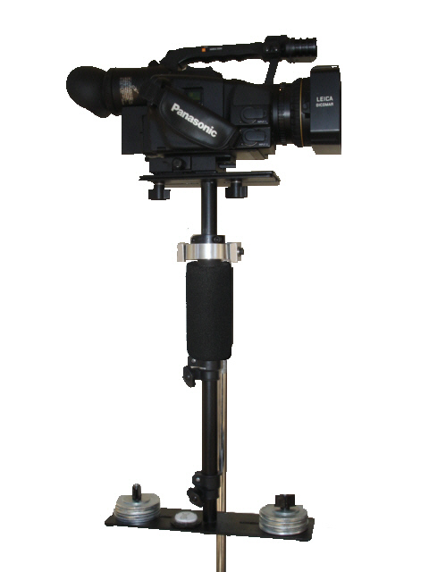

We use the 577 on our own personal system (see attachment) and would include it on all the sleds that we sell but the quick release plate needs to match up to the tripod that the operator is using. If everyone had a 503 Manfrotto head then there wouldn't be any problems.
I read you post a few times and looked at the picture. I would suggest getting the 577 quick release and mounting plate because you can do fore and aft adjustments on the Glidecam using the 577 dove tail plate. This is much easier than loosening 4 screws and moving the Glidecam camera stage fore or aft. The 577 mount does move the camera slightly higher but not nearly as much as what the tilt head would do.
