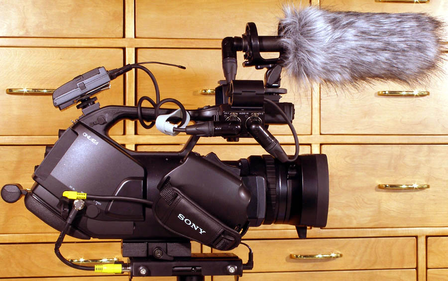

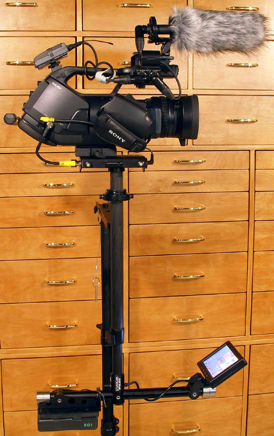

I've flown 4 different Sony cameras on the Pilot (EX1, EX3, V1U, Z1U) and they all seemed slightly heavy on the lens end, so in order to get good dynamic balance, I had to move the tripod adapter 1 hole back in the Pilot's cheese plate. Here's how it looks with the EX3:
http://www.dvinfo.net/forum/attachme...-z1-ex3_1u.jpg
http://www.dvinfo.net/forum/attachme...ped-ex3_2s.jpg

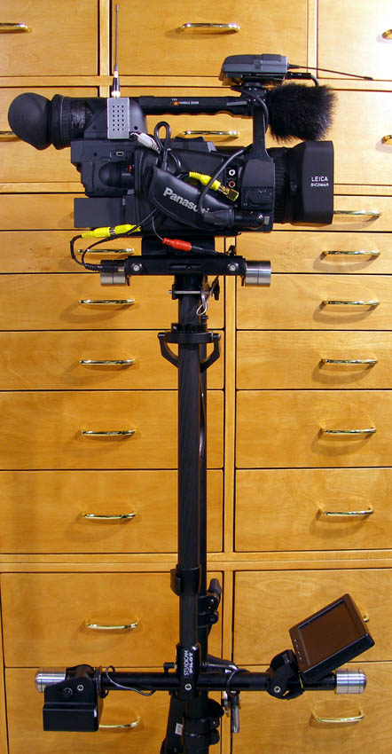

By comparison, the HVX seems to work fine in the middle hole.
http://www.dvinfo.net/forum/attachme...r-p9030095.jpg
