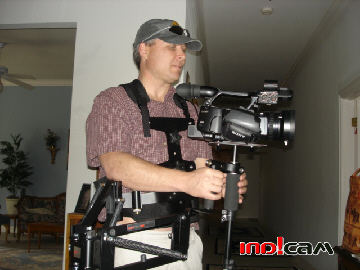

Attached is a picture of a guy who bought our system for his EX1. He actually flew in to our local airport to try out the Indicam PILOT with his EX1 and ended up taking a full system home with him.
When properly set up, operating our system (and others) isn't that hard although you will notice a muscle in your lower back (right side) getting a work out. It's a muscle that is called by steadicam operators "that muscle" and it gets stronger with normal steadicam practise and use.
Make sure the weight of the system is going through the center of your body and not pulling in any other direction. This will help greatly to minimize strain and allow you to operate your rig longer. The adjustment for this is different in different rigs but it has to do with the angle that the arm leaves the vest. When properly adjusted you should be able to have your sled in correct operating position without it wanting to pull away from you in any direction including towards your body. Do some searching on this website for something like "socket block adjustment" and read what others have said. There are some very smart people on this forum who give up hours of their time to help all of us.
