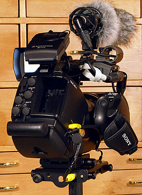

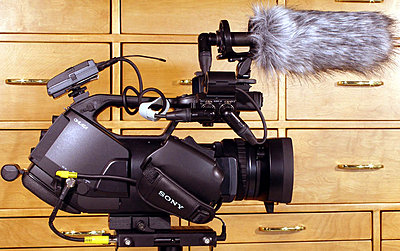

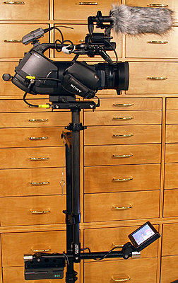

Originally Posted by Cathal Hegarty View Post
Anyone care to post some images or footage flying an EX3 successfully on a pilot?
Images below.
Steadicam vs. Glidecam for EX1/3-ex3_1.jpg   Steadicam vs. Glidecam for EX1/3-ex3_2.jpg
Steadicam vs. Glidecam for EX1/3-ex3_3.jpg
what was the total combined weight?
With these accessories, it's right at the limit. I had to crank the blue thumbscrews all the way up to get the Pilot arm level.
and your powering the camera from the rig right?
Yes, using a custom cable with 2.1mm and Sony EIAJ DC right angle connectors. Note that the yellow Sony EIAJ DC plug really needs to be right angle so it doesn't hit your left cheek. I chopped that connector off the end of this cable.
Vortex Media: VIDEO & PHOTO Tools and Training
Note that the composite video out BNC connector is also right angle for the same reason.
also what shotgun are you using there?
Rode NTG-1 shotgun, Rode SM-3 shock mount, Rode Dead Cat windscreen, Custom cable with Neutrik NC3MRX-B & NC3FRX-B connectors.
and did you achieve dynamic balance ok?
Yes, dynamic balance was good. The tripod mount had to go one hole back, so it hangs off the back a little (see pictures). I also had to do this with the Sony EX1 and Z1U cameras to get dynamic balance.
