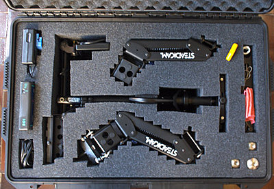

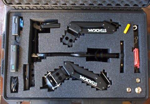

Old March 10th, 2009, 03:39 AM   #7
Location: Italy
Posts: 18
Dave,
I have bought a Storm Case iM2950. It's great! I have to add other accessories such as the customized plate with Manfrotto quick release.
Amedeo
