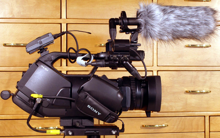

Since we're talking about the EX1 with lot's of extra stuff on it, and if this will work on a Pilot, it's worth noting again here that the Pilot battery will power the EX1.
This is also true for the EX3, which you can see here:
http://www.dvinfo.net/forum/attachme...x1-3-ex3_1.jpg
http://www.dvinfo.net/forum/attachme...x1-3-ex3_2.jpg
http://www.dvinfo.net/forum/attachme...x1-3-ex3_3.jpg
In order to do this, you will need a custom cable that goes from 2.1mm to the special sony power connetor.
Dave Gish is offline   Reply With Quote

Originally Posted by David W Williamson View Post
So when they say that the Pilot can support cameras up to 10 lbs, I take that to mean the weight of the camera and only the camera.
Camera plus all accessories, including Pilot screw-on weights and Pilot battery.
The stock EX1 weighs about 6 lbs. Say some accessories are added (big battery, mic, wireless packs,etc), bringing it to 9lbs. That still falls in the range of the Pilot, does it not?
Sort of.
My Rode NTG-1 short shotgun, shock-mount, Dead-cat furry windscreen, and cable with 2 right angle XLRs weighs around 3/4 pound.
The Sennheiser G2-100 wireless receiver, 2xAA batteries, and cable with right angle XLR weighs just over 1/2 pound.
The Pilot works best with a couple of screw-on weights on either end of the bottom cross-bar. This adds 1 pound.
The Pilot battery is around 1 pound, unless you use a huge VL or AB battery.
You'll probably want to buy a tripod adapter/plate so you can move the camera from Steadicam to sticks easily. The Manfrotto adapter weighs just over 1/2 pound.
Amazon.com: Manfrotto 577 Rapid Connect Adapter w/Sliding Mounting Plate (3433PL): Electronics
The EX1 weighs around 5.5 pounds without a battery.
There's not a lot of incentive to fly the Pilot/EX1 with the big EX1 battery. In fact, it's probably better not to use a battery at all. The Pilot VLB battery works great with the EX1. Same is true for the EX3, as shown here:
More on that here:
http://www.dvinfo.net/forum/stabiliz...r-options.html
Here's my rule-of-thumb:
You want to keep all the stuff you add to the top (camera, camera battery, accessories, and any screw-on weights) to total around 8 pounds. The bottom weight (Pilot battery plus screw-on weights) should total around 2 pounds.
