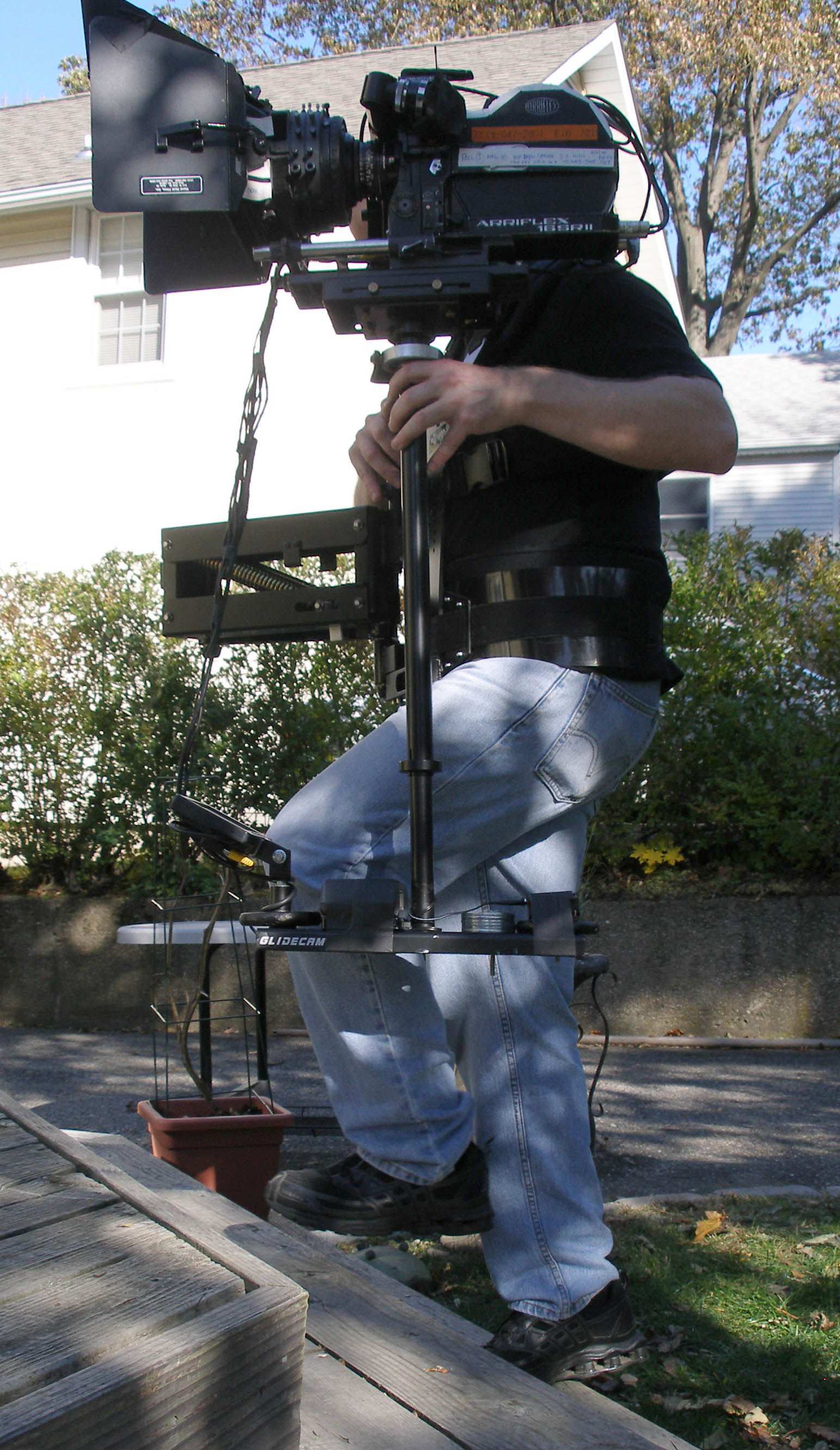

If you cable from the front of the camera stage down to the monitor in a straight line, there will be no operating issues (you'd have to spin the camera around and see yourself before the cable would restrict you). You would need to disconnect it for spin balancing, but the weight of the cable wouldn't change anything once you had achieved dynamic balance. It's not as ideal as recabling the rig down the post but since money is a factor...
Straight, meaning fairly tight, so it doesn't flop around. I can confirm that it doesn't get in the way during operation. But if you want to lengthen or shorten the post...
