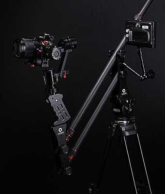

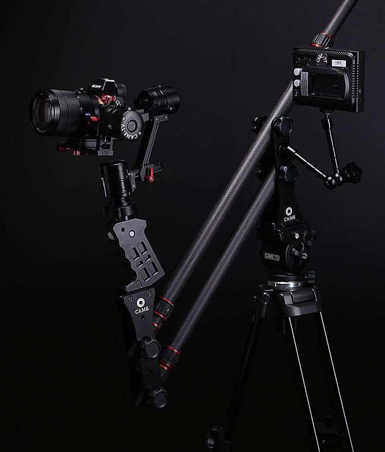

If you limit BMPCC to MFT lenses there's the CAME-TV Single
Not exactly same use as yours but they do show this on a small jib.
http://www.came-tv.com/images/catego...gx7-gimbal.jpg

Yes, that was recommended earlier.
I've passed on suggestions and the shoot is early next week...I have a guess they forewent any "newfangled" gear and found a mechanical way to do it.
Charles Papert
www.charlespapert.com
