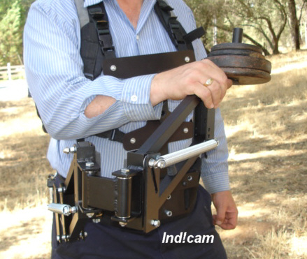

We just tested out a prototype of our arm which will hold a total of 14 pounds (6.4 kg). The sled usually weighs 5 pounds (2.3 kg) so the prototyped arm will hold a payload (camera and accessories) of around 9 pounds (4.1).
We will probably want to add more counterweights to the bottom of the sled so it will weigh around 6.5 pounds (2.9 kg) giving us a camera and accessories weight of 7.5 pounds (3.4 kg). Hopefull when were finished we will be able to fly a few more of the larger cameras.
The JVC HD100 would be in range but the Canon XL H1 might be just a bit too heavy. We could probably keep the bottom plate at 5 pounds and drop the extension as far as needed to balance the XL H1 correctly.
One thing I know, it's harder on the body to fly the extra weight. It's still not bad but it is more noticeable. On the plus side, the heavier cameras will also be more stable.
The prototype-when it's incorporated will sell for around $150 more due to extra manufacturing and labor costs.
The picture shows the adapted arm supporting 14 pounds. The weights are 2X5s, 1x2.5, and 1x1.5.
Smooth Shooting!
Terry
