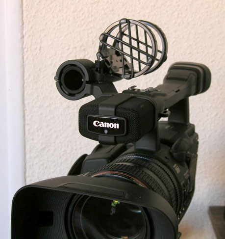

Tring to balance the A1 with the mic Rode NTG2.
If i put the mic in the mic holder(with the help of little foam to fit) i'm able more or less to have a good balance,problem being that the deadcat shows up in the image.
Total weight is less than half pound(Rode NTG2-cable-Deadcat)
So i'd like to use the RODE SM3 shock mount in the hot shoe,with this setup i don't see the deadcat anymore in my image but.........seems impossible to balance the MERLIN.
Total weight is little more than half pound(Rode NTG2-cable-Deadcat + Rode SM3 shockmount).
Just wondering if mounting the SM3 Shockmount and putting the Mic so high is the problem,or if it is just a weight problem that maybe can be solved buyng the new GIMBAL that can handle more weight.
Does anybody have any experience with this (or similar) setup?

Mounting it high like that is throwing the center of mass higher on the setup. There will be a limit as to how high you can go. Adding weight to the lower point or adjusting the "gimbal to stage" height can help to a point.
I am trying to figure out how to mount my Sennheiser wireless receivers without screwing up the COM. A standard hot shoe adapter works well on a tripod but on the Merlin it needs to be lower for me.
The Rycote hotshoe mount (037303 Hot Shoe Extension Bar) might help you out. It can help move the shotgun back on the camera getting it out of frame. This would also keep the camera from getting front heavy.
Good luck and let me know if you figure it out.

Pretty much solved the problem.
I changed the Rode SM3 shockmount
http://www.bhphotovideo.com/c/produc...hockmount.html
with the RODE SM5 shockmount
http://www.bhphotovideo.com/c/produc...icrophone.html
I put it in the clamp mount adapter with a 45% angle toward(as you can see in the photo) the camera center
so the Mic is not so high and the weight is more in the center.
It does work,is not as fluid and comfortable as without the shotgun but being more careful it's ok.
The trimming and the adjustments have to be very precise,everytime i close the arc and reopen it i have to make small adjustments,also probably do to the fact that in the shockmount the mic moves a little bit.
The added weight and the fact that the shotgun is still high probably put this setup on the edge of usability.
The setting of the Merlin are
FRONT WEIGHTS 1 finish
LOWER WEIGHTS 1 Start 6 Mid 1 Finish
ARC SIZE completely open
Mt HOLE I
STAGE MARK -1
Z 1

Thanks for letting us know how you solved your mic problem. Your pictures were a big help as well.
