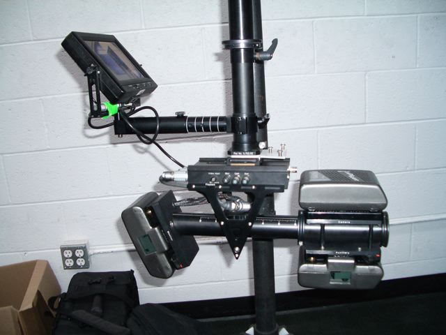

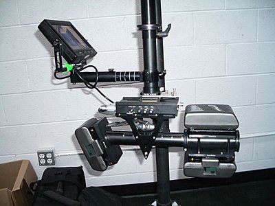

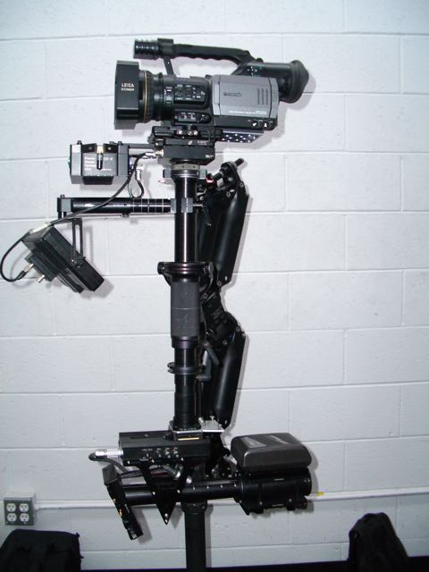

Here are a couple of old pix I found where I was testing the absolute lightest my full-size rig could be built into, for DV cameras. My 5" LCD (since replaced with newer version) that I used for running shots or as a backup to the green screen is shown here with custom yoke mount as described above.
The second image is an especially unusual configuration, with the monitor mounted above the gimbal to add some needed weight to the top of the rig. Realistically I wouldn't work with a setup like this (this still puts the gimbal way too low on the rig), I would either use a lighter sled or add weight to the top stage, but it was an interesting experiment.
Monitor For Glidecam 4000-batthang1.jpg   Monitor For Glidecam 4000-batthang2.jpg
