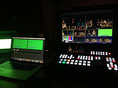

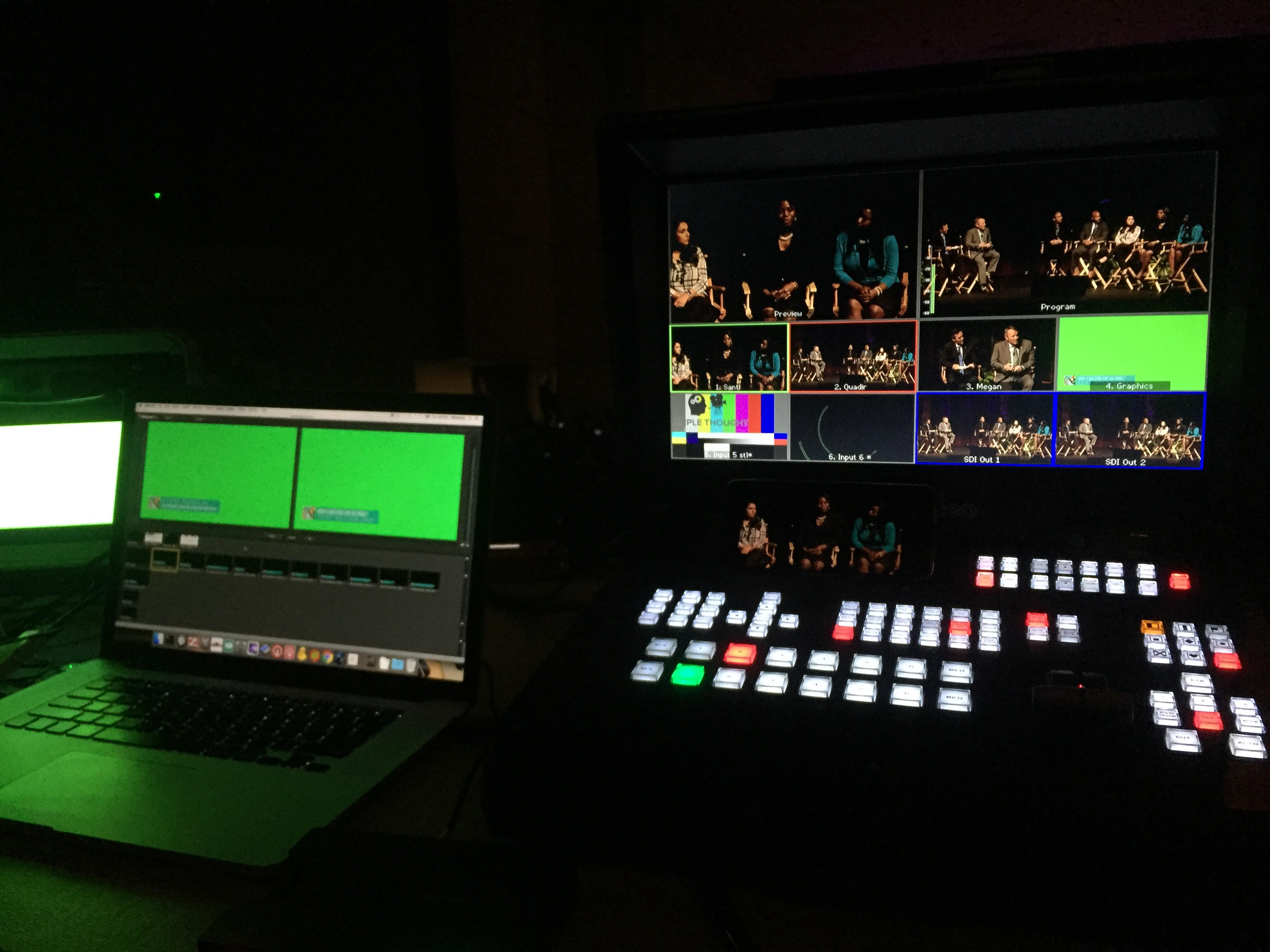

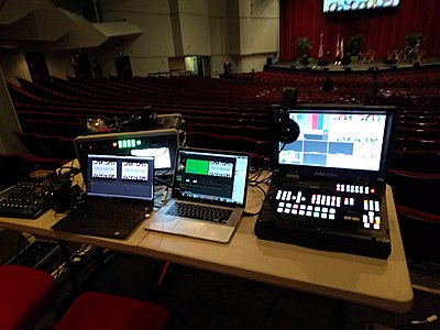

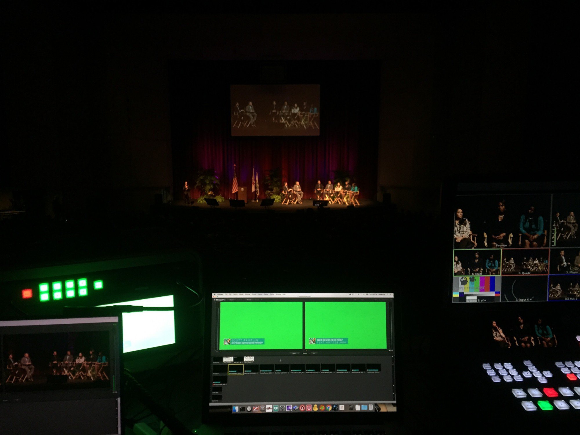

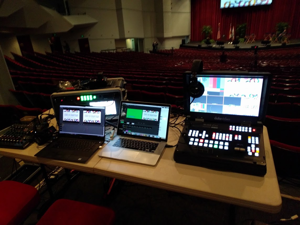

Just recently did an event for the City of Orlando where we mixed 3 cameras, graphics and media into a live stream that went to their main website along with Facebook live. We also provided IMAG for the house audience as well as providing a confidence monitor down on the stage. The recording can be found here:
Setup was pretty straightforward and used the following:
Datavideo HS-1200 mixer
Datavideo ITC-1000 Intercom/tally
Yamaha Mg10xu Audio Mixer
3x - Canon XF-305
Laptop running Wirecast with HDMI out to power the graphics and video playback
Laptop streaming over RTMP (Wirecast) and recording an MP4
BM HyperDeck Shuttle 2 recording the pgrm out
Each camera operator had intercom and tally. We also ran intercom to the stage manager so they could queue the show flow as people entered and exited the stage. From the production side there were 5 people. 3 Camera, 1 Graphics, 1 Director.
Attached an image of the setup before and during the show. Happy to answer any questions if there is any.
