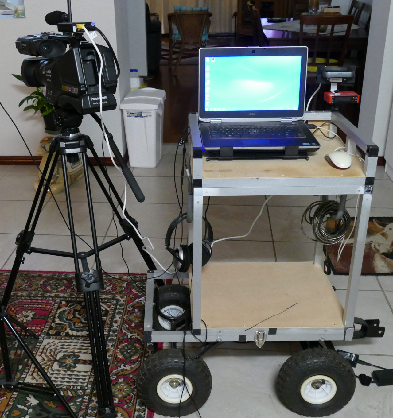

Old August 18th, 2018, 05:36 AM   #15
Posts: 8,441
Re: Mobile streaming to youtube
Sounds good Simon
What I use if I need a solo shoot with multicameras is use my main camera into the switcher and then plug in a couple of Logitech 930e conference cams for cutaways and that's quite manageable by one person ..I actually bought a Bunnings Garden trolley (originally for normal video) and have modified it now so it carries the laptop with switcher software and encoders/router ... make a neat package where you have the opportunity to sit down and stream!!
Chris Harding is offline   Reply
