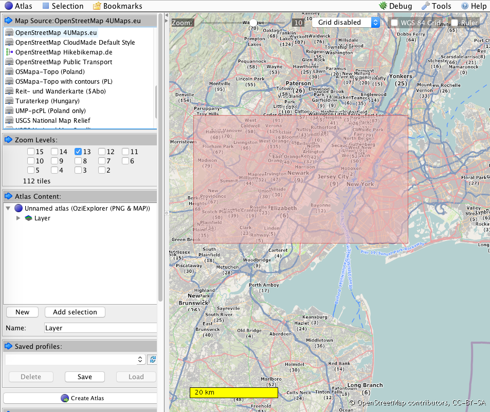

Like many things, this comes down to having the right software. I make maps, and there are many ways that I can think of to do this. The examples that have been posted are a good try at problem-solving, but are pretty kludgy. :)
Here's a suggestion: install the free, open source Mobile Atlas Creator program - it runs on Macs, Windows and Linux. You will need to install Java if you don't already have it and that can be confusing unfortunately. I have written a tutorial for installing Mobile Atlas Creator and Java, you can read/download the PDF file here (I should update it again)
https://boydsmaps.com/mobile-atlas-creator/
I don't know what kind of map you want - there are many free sources of maps and imagery available. Here's a quick example using OpenStreetMap. I'll assume that you have followed the tutorial above and installed Mobile Atlas Creator.

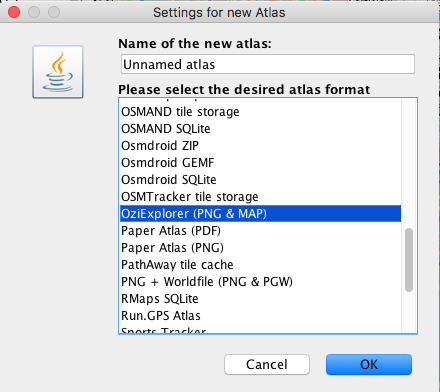

Start the program and create a new atlas in OziExplorer format (see attached screenshots)
Now choose OpenStreetMap 4uMaps.eu as a mapsource and drag/zoom the map to the location you want. You must hold down the RIGHT mouse button to drag the map (not very intuitive)
Use the left mouse button to drag a box over the area you want. I suggest doing a quick test with very small area for starters.
The Zoom Levels checkboxes will select the resolution of the map. For a first test, choose a small zoom level. Each level is twice the scale of the previous which means 4x the amount of data. Level 15 is a resolution of 4 meters per pixel, which could produce a very large image depending on the area you select. ONLY CHECK ONE BOX here. This setting has nothing to do with the scale of the map in the viewer, you can zoom way out there to make it easy to select the area you want.

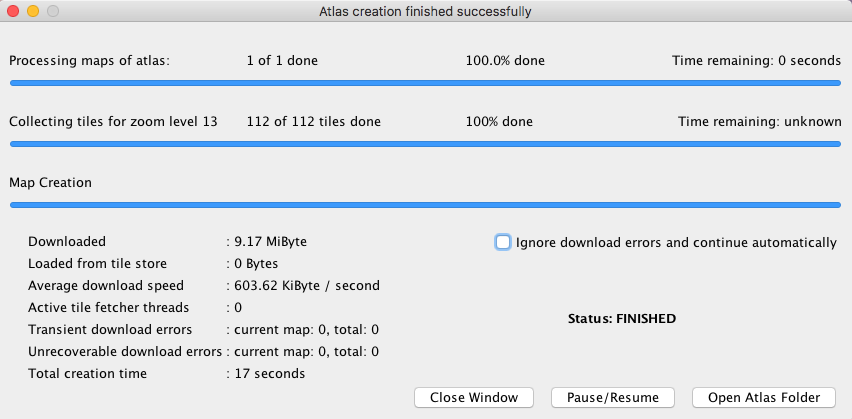

Click the Add Selection button and you should see it appear in the Atlas Content window.
Now click the Create Atlas button. When it finishes you can click the button to open the atlas folder. Open the enclosed folders and you will find a PNG image and another file that you don't need. In this example, it took around 30 seconds and created a 3584 × 2048 image. The speed of your internet connection will affect this, of course.
There are a lot of other built-in map sources you could try, the USGS has topo maps and aerial imagery, there are also free topo maps for Canada. Also possible to add other mapsources, but that gets complicated.
Does anyone know how to do this video map effect?-screen-shot-2020-12-04-1.49.19-pm.png   Does anyone know how to do this video map effect?-screen-shot-2020-12-04-1.54.11-pm.png
