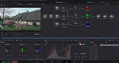

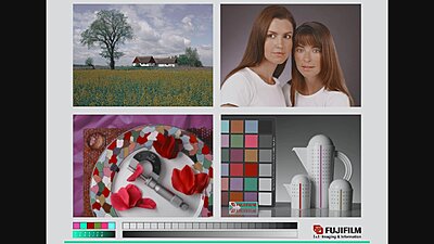

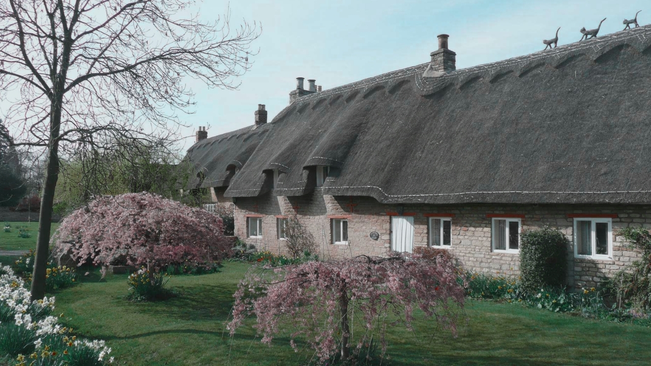

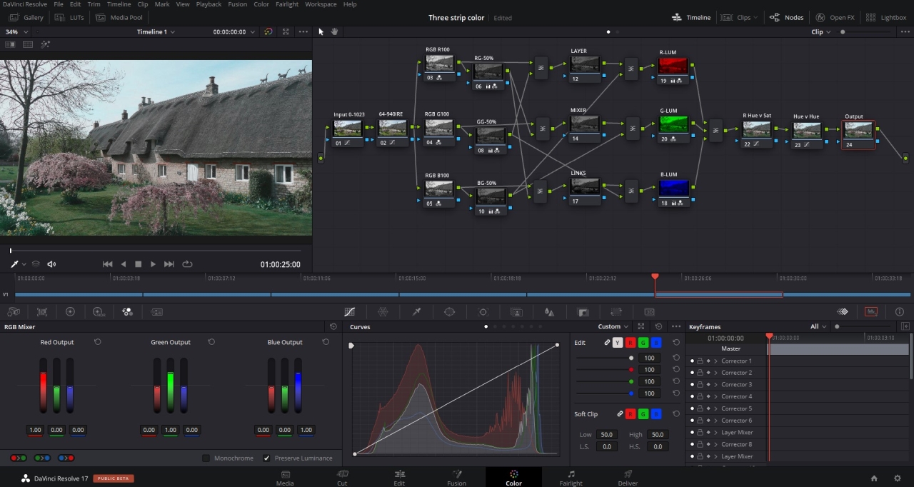

In film processing, the start of the three-strip color process was Technicolor which actually used three black and white films that were subsequently colored. I won't explain the process as there is tons of info on the Technicolor process floating around the web. Once all that moved into the digital domain that's where the ability to really play with color 'artistically' in the three-color process really took off.
If you learn to work with the three-color strip process in say Resolve you can at various stages in the node flow create a massive amount of color tint influence individually in each of the R, G, and B channels when you separate them out from your image. At this point, you can also adjust the luminance levels of each channel. Then by using the Compositing Subtract mode in your first Mixer Layers you can then push those mixer layers into a second series of linking nodes and then onto the second series of Mixer Layers where you can use the Compositing Add function. The final output of the second of your Mixer Layers is then stripped of maintaining any luminance and run into a final Mixer Layer then output for final "tweaks".
Using the above process it's not too hard to emulate almost any of the popular three color film looks. Below are three images. #1 is of a full gamut 0-1023 RGB image, take note 8-bit image, that has been manipulated to a 64-960 broadcast video level image using the three-strip color process. Image #2 is a more muted 'older color film' look one might say. That's the result of processing in the three-color strip mode. This particular image has been graded lightly to favor the Brown/Green with Red as an accent color. Notice the red window ledges. The final image #3 is the node flow of how to work within the three-color strip process. To truly emulate the original Technicolor process you need to introduce the three complementary nodes with the colors of Cyan, Magenta and Yellow which these examples don't have.
When you are happy with your results it's then a simple matter of exporting a 3D LUT if you want a quick flow after that. An incredibly flexible powerful workflow as all your manipulation is done in each individual RGB channel without affecting other channels until you recombine with your Composite Add Mixer Layers. What I'm getting at is even if your image is 8-bit by working within the actual individual RGB channels you can output a pretty solid image. Finally same three-color Brown/Green Red but using the Fuji girls.
Chris Young
Do a lot of movies use this 3 color rule?-original-still_1.6.4.jpg   Do a lot of movies use this 3 color rule?-3-color_1.7.1.jpg
Do a lot of movies use this 3 color rule?-resolve-3-color.jpg   Do a lot of movies use this 3 color rule?-original-fuji-reference_1.4.1.jpg
Do a lot of movies use this 3 color rule?-3-color-fuji-reference_1.4.1_1.8.1.jpg

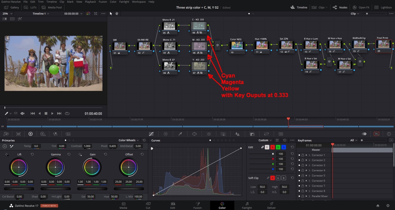

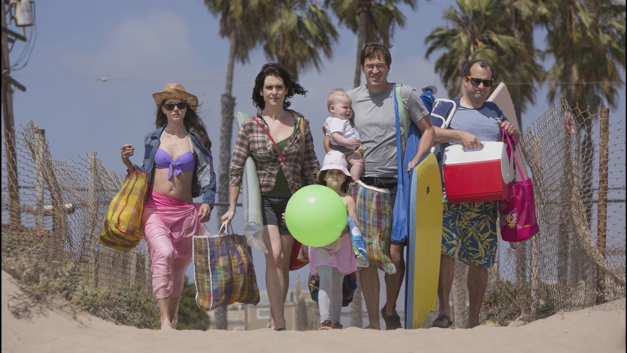

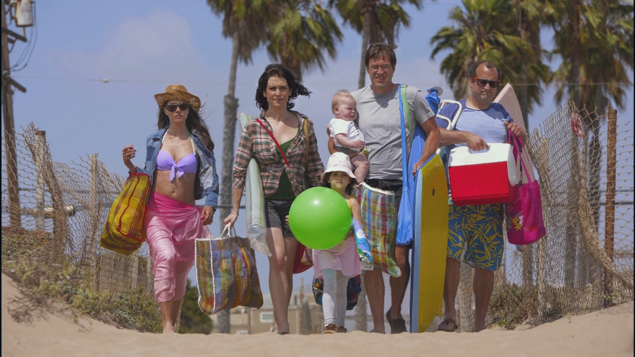

Old January 2nd, 2021, 08:16 AM   #29
Location: Sydney Australia
Posts: 1,622
Re: Do a lot of movies use this 3 color rule?

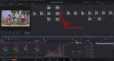

Just thought I have a look at the RGB 3 Color Strip with the correct Cyan, Magenta, and Yellow strip added. I quite like the results. It gives you an impressive amount of control over your final look. Not saying this is a definitive look but it gives the following image that came from a show, can't remember the show's name a totally different look. Quite different when applied to the general run of SOOC images. Much more of that saturated Technicolor POP! What I love about the process is it doesn't affect the Black and White content of your images. They constantly remain B & W regardless of any color manipulations.
Also played around with S-LOG3 using Resolve's Color Transform and then applying this 3 Color + C, M, Y node tree.
My pointers came from an old page that no longer has its frame grabs. The process was well documented thought so wasn't too hard to follow if anyone is interested.
https://sites.google.com/site/intert...-strip-process.
Before and after samples plus the node tree below:
Chris Young
Do a lot of movies use this 3 color rule?-beach-native-off-video-720-.jpg   Do a lot of movies use this 3 color rule?-beach-rgb-three-strip-cmy-720-.jpg
Do a lot of movies use this 3 color rule?-beach-node-tree-three-strip-c-m-y-720-.jpg
